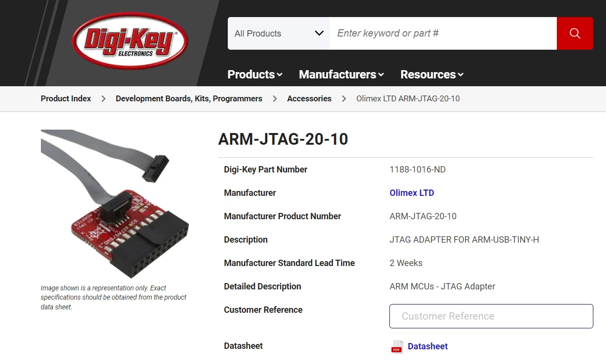

STLinkV3 is considered a refresh of v2 and has MIPI14 connector as it includes USB to UART translation. You can cut corner pins to get MIPI 10, or you may find JTAG 20 to MIPI adapters online or at ST partner debug probe accessoriee.

Isn't that still all 0.1 inch pitch?

Aren't there some 10 pin cables with 14 pin header crimped on one end?​
