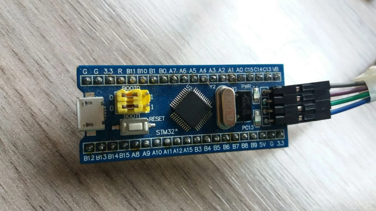

Yes, it has this yellow jumper as you can its BOOT0 pulled LOW (zero).
Actually, I always load the code in this mode, and has always worked, never needed to put boot0 high as showed in tutorials on the internet.

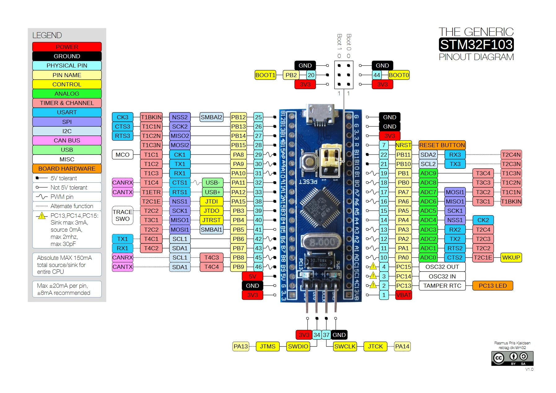

0693W000006HdEAQA0.jpgIt has the white reset button and the reset pin(next to B11) but I'm not using this pin. I can't use it when I configured the pins in CubeMX, It's connected to the button as you can see in the schematic below.
