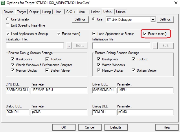

Hello everyone,
I am using stm32f030k6...
When I am using ST-Link debugger and go into debug state, the Keil IDE goes to an assembly file 'startup_stm32f030x6.s  ' and get stuck there right at the line:
LDR     R0, =SystemInit
and I can't move futher using Step Over key (F10). when I do not use debugging and just download the code, the system is working as I expected but with this situation, I can't debug my code.
Is there anything wrong with me? Does anyone know how to get out of this trouble?

If you want to go directly to the main function after starting the debug session, check the option
''Run to main()''
in ''Options for Target'' (ALT +F7) -> Debug. Note that there is the ''SystemInit()'' function called before main (as you can see from the startup). You should be able to enter the function from startup by using Step key (F11).  0690X00000605SgQAI.png

Thanks guys for your replies...
The Run to main() was checked
I put breakpoint on a line in main() and use F5 for running till that breakpoint but nothing happened. and the system remains at running state and whenever I push STOP button, the system was still at the same assembly line
The optimization level was the highest (o3). I changed it to lowest and nothing changed.
I used STM32Cube for making the project.
I also increase stack and heap sizes but they didn't help.
and unfortunately I should say, after rebuilding the project and restarting Keil over and over, at an unknown time the problem vanished. I had been seeing this problem before and always I didn't understand how the problem get resolved.
but thank you anyway

Make sure the 'Update Target before Debugging' is checked in the Options/Utilities pane. And 'Load Application at Startup' is also checked in Options/Debug pane

Hi everyone. I think i've solved this problem. The solution is go to st-link options -> debug tab -> download options -> Uncheck Download to flash. Now debugger works perfectly.
