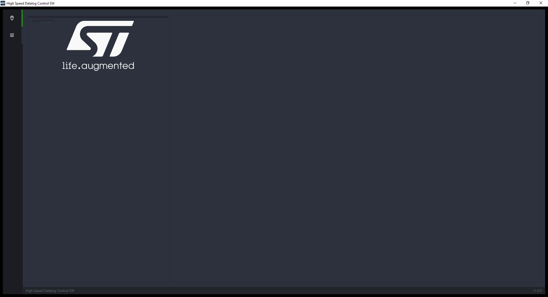

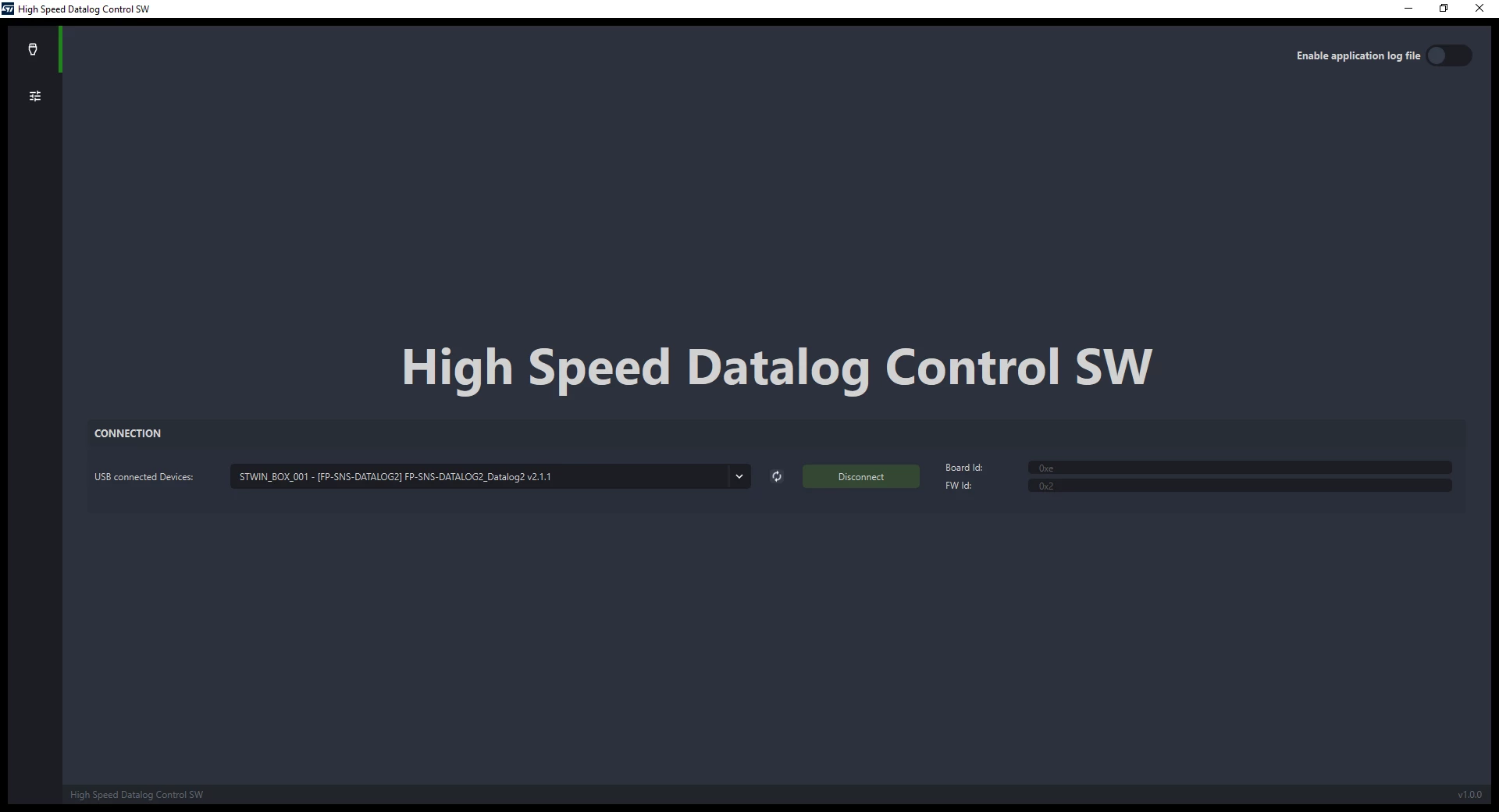

I am trying to use the Python GUI, I can connect to the board....
But there is nothing on the screen once I have connected...
Does the Python GUI work with the FP-SNS-DATALOG2 software ?

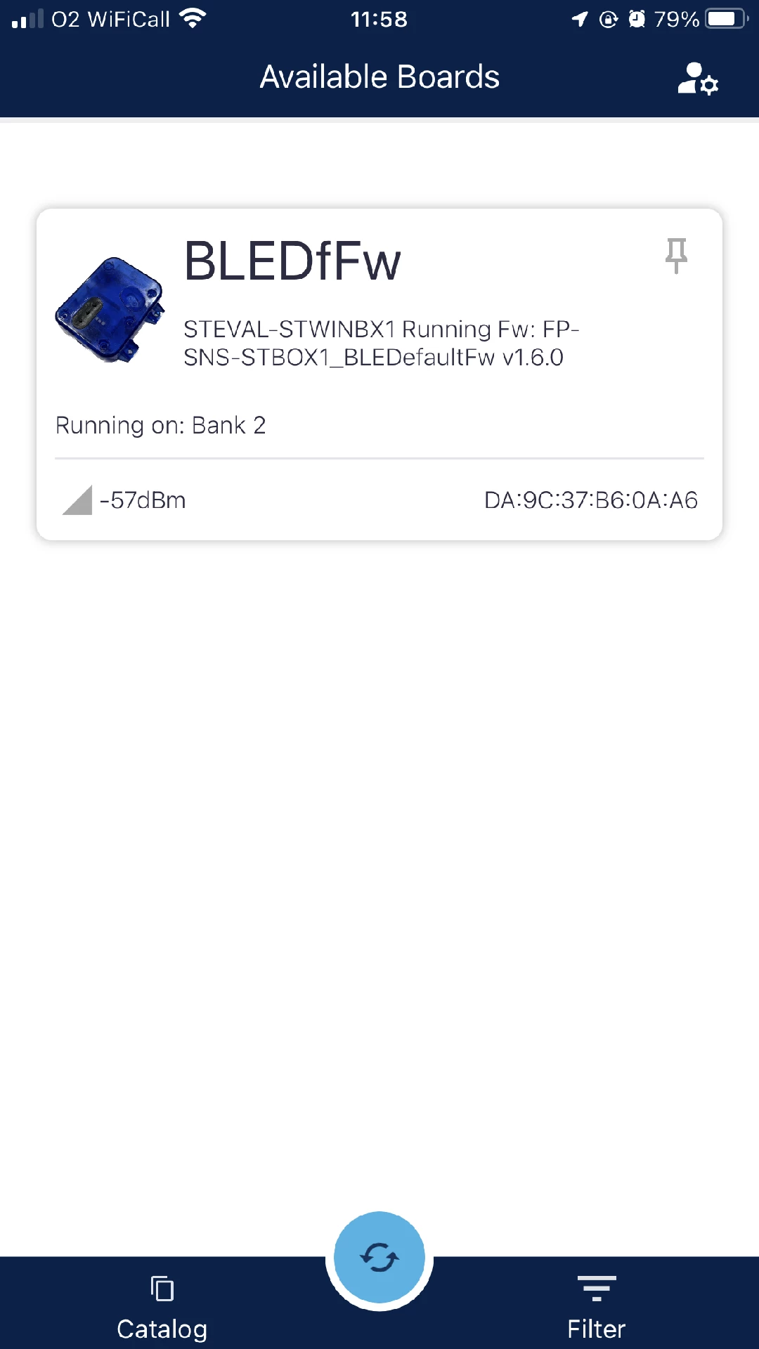

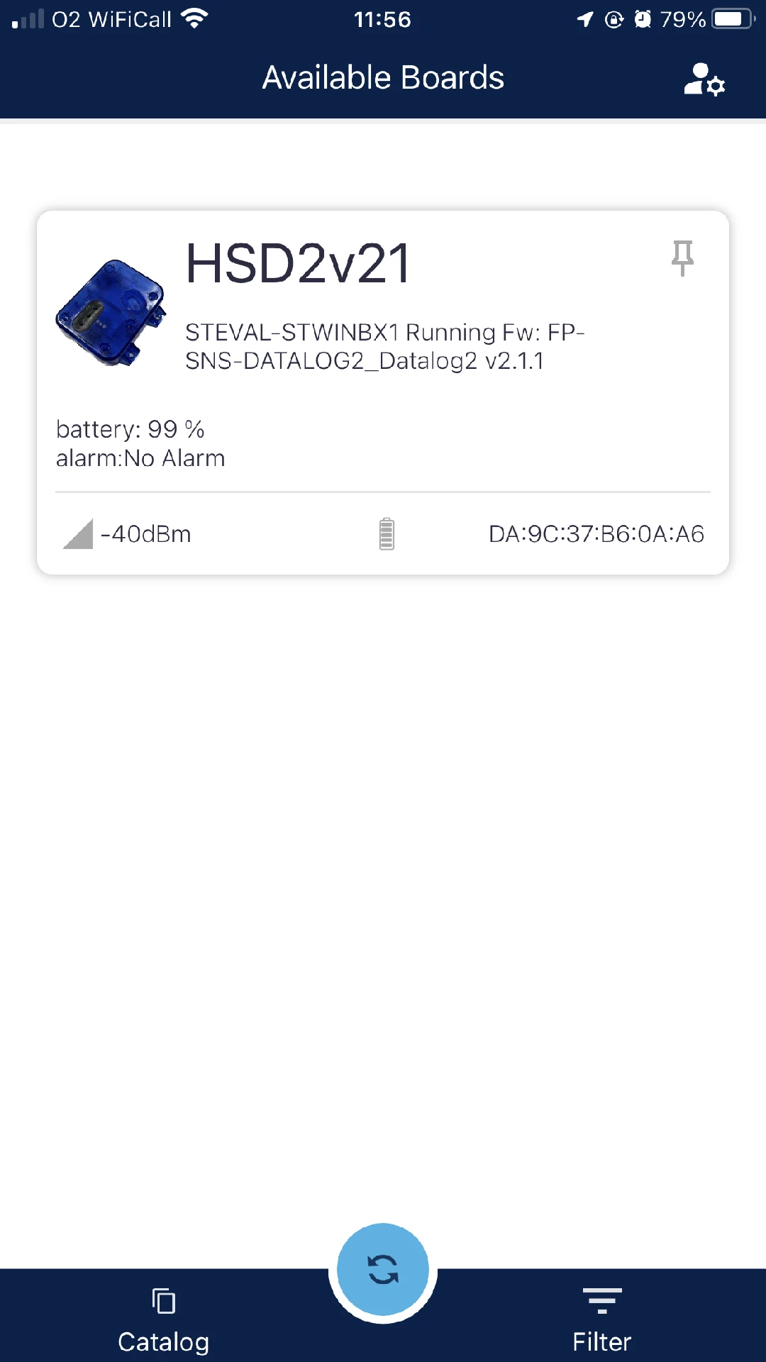

I am able to use the phone app to swap firmware...
If I swap to BLEDfFw firmware (running on bank 2), the Python GUI does not even detect the device.
