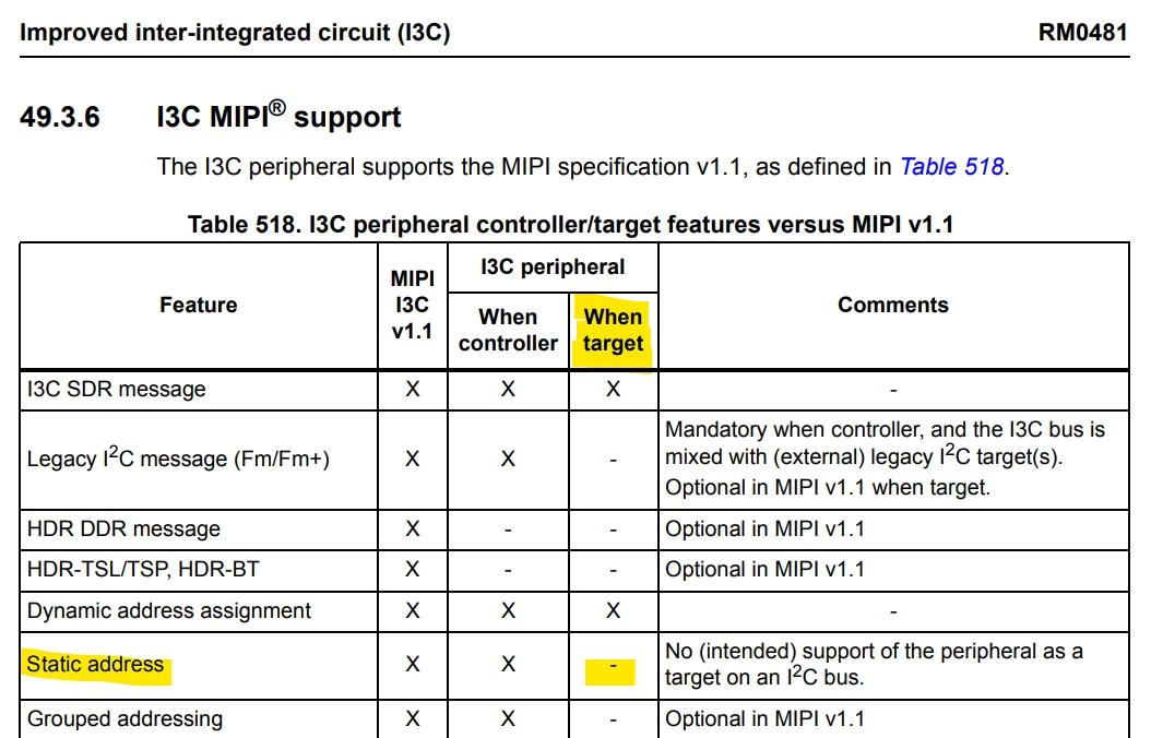

Static addr of I3C in H563ZIT6
I have a H563ZIT6 . I attach its I3C(used as target) to an I3C controller, and then i find that there is no register for static address in target mode in I3C of H563ZIT6, i just find DEVR0 for dynamic address. Does I3C of H563ZIT6 support static address ?
Or what should i do with this I3C if i want to receive data from controller.

TDKBest answer
March 20, 2024
Static addresses on I3C in target mode are not supported. Use dynamic addressing.

Xonier
XonierAuthor
March 21, 2024
Thanks a lot!
