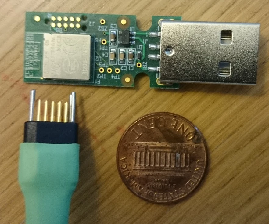

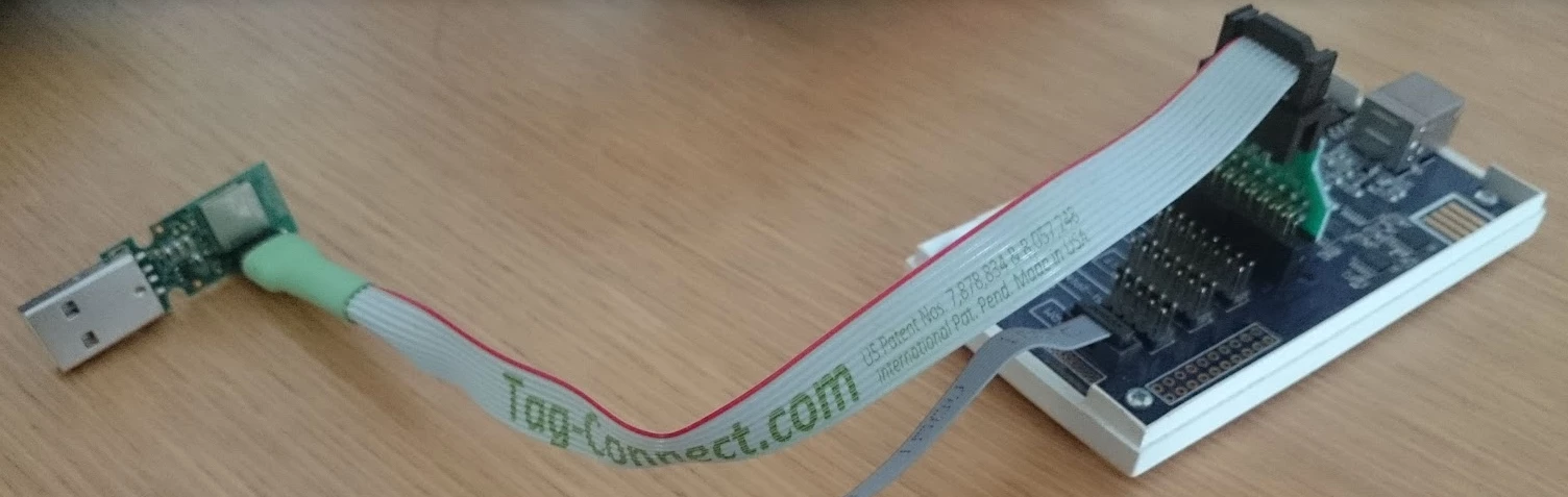

To add to Andrew's observation, Tag-Connect has grown popular as a means to do SWD connection on STM32 and similar platforms.
Andrew Neil
Mar 23, 2024 10:04 AM UTC
Indeed it has!
https://www.tag-connect.com/
I remember meeting the inventor when he was over here first promoting it back in 2010!

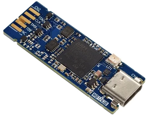

Pavel A.
Mar 23, 2024 2:03 PM UTC

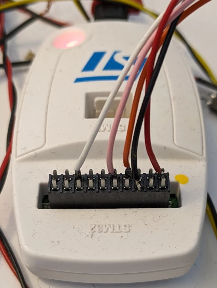

Easy. Just get a new ST_Link V3 and wire up anything to its open contacts.
Andrew Neil
Mar 23, 2024 2:16 PM UTC
not that it's hard to wire up a custom connection to a standard St-Link:
8)
