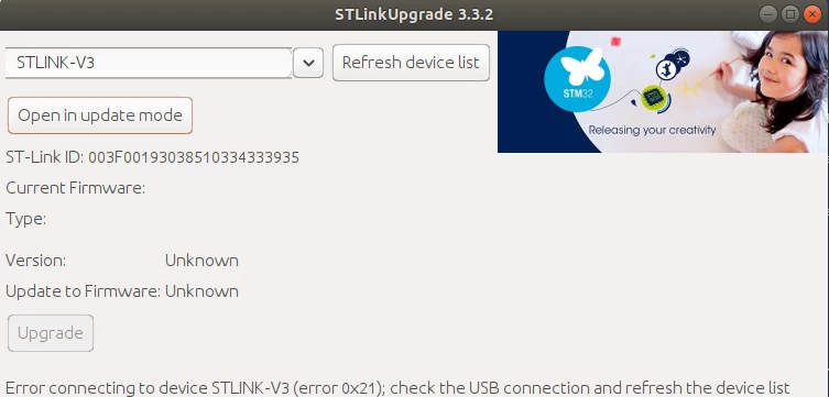

Hi, I tried to upgrade the firmware for my ST-LINK 3 SET (using the STLinkUpgrade came with STM32CubeProgrammer) and something went wrong (didn't do anything special, just clicked "Open in update mode" and then "Upgrade"). Now its "Version" appears to be "Unkown" and it woudn't get into update mode any more with an error message: "Unkown firmware type. Don't know how to upgrade." I was wondering if there is any way to recover the firmware? Thanks!

What happens when you "Open in update Mode"
RDu.1
RDu.1Author
May 14, 2020
It gives an error message as shown below. The "Upgrade" button stays grey.

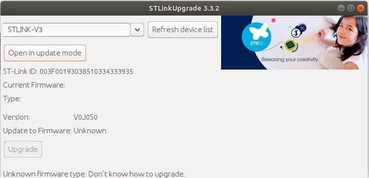

The upgrade is effectivly done by a java file"STLinkUpgrade.jar". Locate that file and try to run direct" java -jar STLinkUpgrade.jar"
RDu.1
RDu.1Author
May 14, 2020
I just tried, this command opens the upgrade tool without starting the stm32cube programmer. But STLink still cannot get into update mode, same behavior and the Upgrade button is unclickable.
