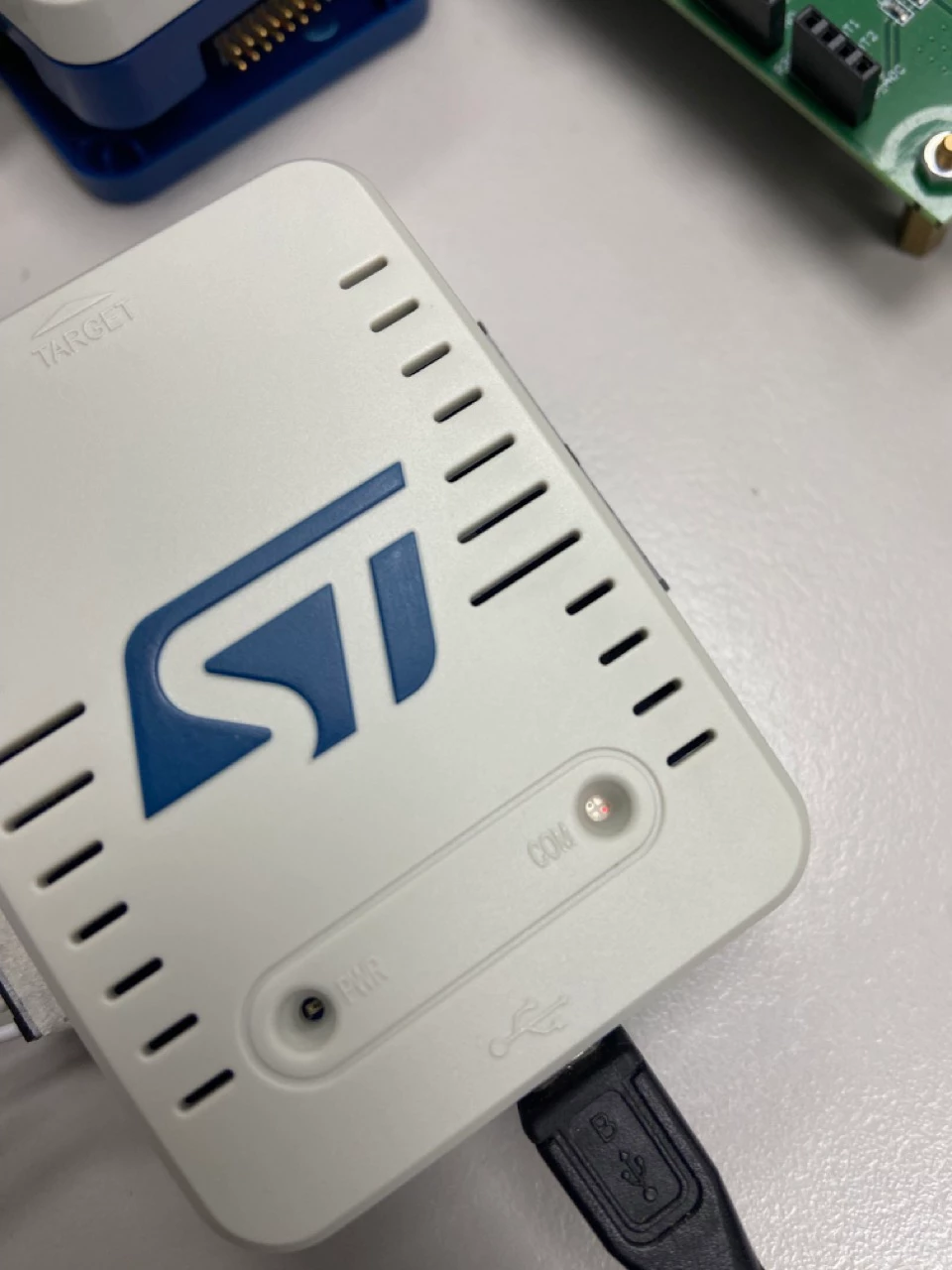

Hi everyone, I'm having an issue with a brand new ST-Link V3 and would appreciate a quick sanity check before I return it.
Here's the situation:
* The device is not detected by my PC at all (it does not appear in Device Manager).
* I have already confirmed my USB-C data cable is working correctly.
* The red power LED on the ST-Link is extremely faint and dim.
* I also tested it on a second computer, and the result was exactly the same.
Since the LED is so dim and it fails on multiple PCs, I'm confident this is a hardware fault (DOA). Has anyone seen this specific issue before? I've attached a photo of the dim LED.

If the problem occurs from out of the box, I agree it is most probably either an hardware issue, or a wrong programming of the board; so I suggest to ask for an exchange. Before this, may you please have a look in the device manager (if you are on Windows), in "Universal Serial Bus Devices", if you see "STM32 ST-LINK/V3", or any failing device ? (in this last case, it could be helpful the check, in the device details, the USB vendorId (ST=0x0483), and USB productId)
May you please also precise the data on the sticker of the probe (something like LKV3SET$xxx and a serial number with 1 letter and 9 digits), so that I forward to the industrialization team for analysis.
Thank you and sorry for this trouble
