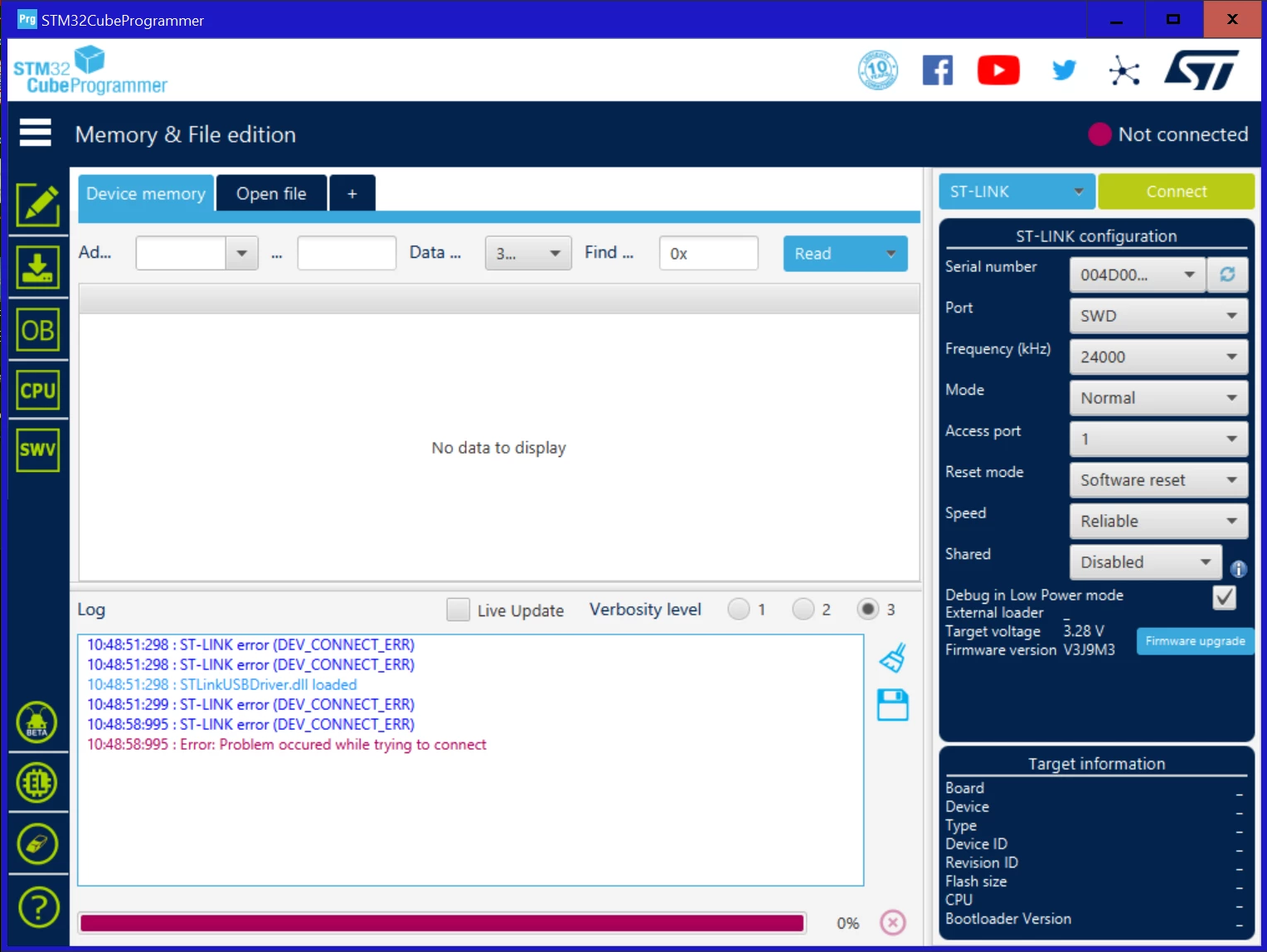

I have three STM32H7B3IDK
They all have different serial numbers.
I am running two boards OK one on the old STMStudio gathering data the other connected to CubeIDE.
I can connect the third and can scan for it in CubeIDE and CubeProgrammer, but when I try to connect i get a connection errror.
0693W00000Kc1k1QAB.pngWhen I try to debug the third board in CubeIDE I get:

I can connect, program and update the ST-Link firmware on all of the boards, but when a third one is plugged in I can update its firmware, but not connect to it.
I have tried three different USB ports and two different USB cables. All with the same result.
When I plug the third board in the comm port gets activated and the file explorer opens showing the MBED.HTM and DETAILS.TXT.
I am running IDE 1.9.0 and Programmer 2.10.0.
Is there a limit on the number of connections you can have or is this some sort of problem.
I often have two boards connected; one undergoing a production test, the other being used for development. I think? this is the first time I've tried three boards.

The problem turned out to be STMStudio. I had this running on a Disco. board. STMStudio doesn't seem to cooperate with the latest drivers/software. It also prevented the Programmer from connecting to targets.
