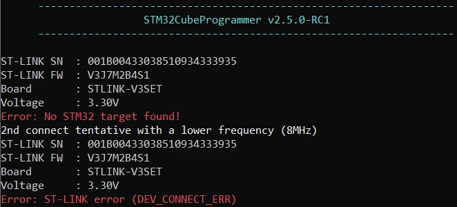

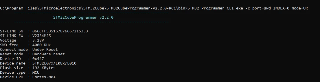

Jutt
JuttAuthor
June 22, 2020
@Nesrine.JLASSI​
short feed back from side. stm32L07x family is working fine.
when i test with stm32L051.i have same issue.
St link V3
Cube programmer V2.4
connect under reset.
here is error msg from cubeprogrammer "Error: ST-LINK error (DEV_CONNECT_ERR)"
thank you
OE1
September 4, 2020
Greetings,
I'm also experiencing the same problem with both stm32L051 and stm32L052 when using STLINK-V3.
No problem on stm32L452.
Here's my command line for it :
STM32_Programmer_CLI.exe --connect port=SWD mode=UR reset=hwRst --download "software.bin" 0x08000000 --verify -Rst
and what it shows :
Exact same command with same STM32_Programmer_CLI.exe works perfectly when using STLINK-V2.
Any possible fix?
Thanks forward
