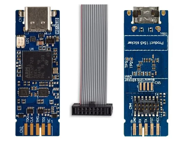

Hello everyone, the STM32F723IEK6 chip on my H755ZI-Q development board is damaged. If I replace it with a brand new MCU, how can I restore the program

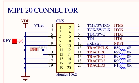

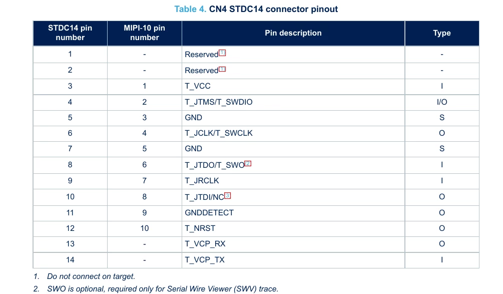

So better just buy an st-link miniE , has the 14pin ->
and your board has the 20pin ->
So it should work with the cable in the "right" position : vdd , swd,...reset , matching the position on the cable connector vcc, swd...reset.

you cannot.
Because STM keeps the st-link firmware secret, you only can buy a st-link V3 (miniE or mods , are not much more expensive than buying a F723 cpu).
XSMSQAuthor
Aug 17, 2025 8:04 AM UTC
 Bro,Can I purchase ST Link V3 and transplant the chip

Basically - yes/maybe. But firmware not same , it still will "know" its a st-link V3. And maybe says "error"....
afaik nobody did this .
ed: here he did it:
https://dalaotech.com/2021/08/26/1107/
(maybe, use translate...)
And big risk, if its not working , you just damaged board and st-link.
(de- and re-solder an BGA , you can do this with good experience on BGA rework?)
And maybe remove the dead F723 , if it heats up or is shorted.
