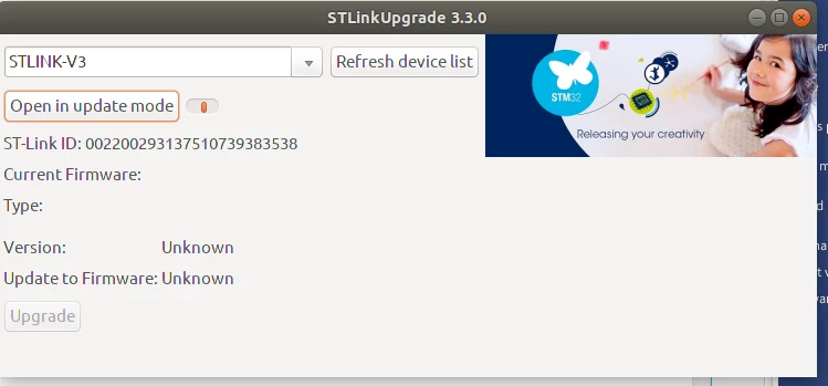

ST-LINK V3 firmware upgrade failed
  • October 24, 2019
  • 3 replies
  • 1986 views

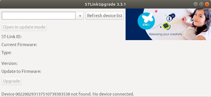

0690X00000Aqr6VQAR.png0690X00000Aqr6aQAB.pngI am using Ubuntu 18.04 VirtualBox on MacOS with STM32G484QE-EVAL baord. While switching to STM32CubeIDE 1.1.0, the debug tool will ask to upgrade the STLINK V3 firmware. Clicking the upgrade button and "STLinkUpgrade 3.3.0" will start. Click "Open in update mode" button it starts to update. However, after a while, it failed. See the attached images.

In Virtualbox, when the device reenumerated, it most cases it detaches from Virtualbox. Reattach logical, with the VB control, not physical detach...
JasonZ
JasonZAuthor
October 25, 2019
Reattached and run the STLinkUpgrade again and it still fails.
Uwe Bonnes
Chief
October 25, 2019
Try on a native machine, without VM.
