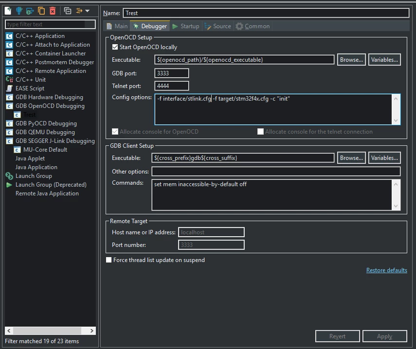

Here is funcion solution.... for STM32F427 and SWD programming.
-f interface/stlink.cfg -f target/stm32f4x.cfg -c "init"
