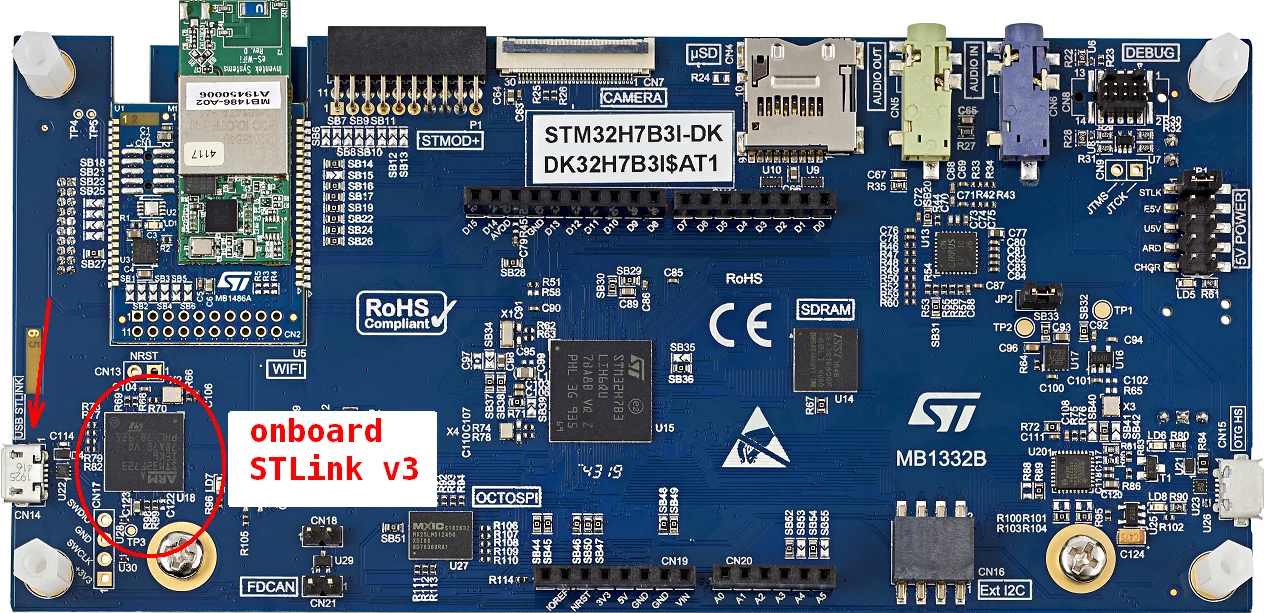

Hi Team
I have purchased the STM32H7B3I-DK I find that there is no power cable provided,Its just the board that is provided
I see that we need to purchse the STLINK V3 , But i see that on the Board it is USBTYPE-B connection for STLINK USB - CN14 ,But the output of the STLINKV3 does not have the usb output and need a connector
I am really confused on how the interface from
LAPTOP (USB) <-------------->STLINK<--------(INTERFACE)------> (USB PORT) <-----DEVELOPMENT BOARD------->
Can you please help on the links what all the components that i have to buy to interface this completely so on the board it will be USB input from STlink V3
Its really in urgent please help on getting the product links to buy and any reference on interfacing to get idea

Tesla DeLorean
Guru
June 12, 2020
Board just needs a standard Micro USB cable to connect to PC. This should not be a charging cable, as the data connectivity is required.
The board has an on board ST-LINK V3, check manual and power jumpers.​

I hope this is the step that i have to do!
Ensure that the JP1 jumper is set to STLK. 2. Connect a Type-A to Micro-B USB cable from the STM32H7B3I-DK board (Connect USB STLINK CN14) to a PC to power the board. Then LD5 (+5V) and LD4 (STLINK COM) light up.
