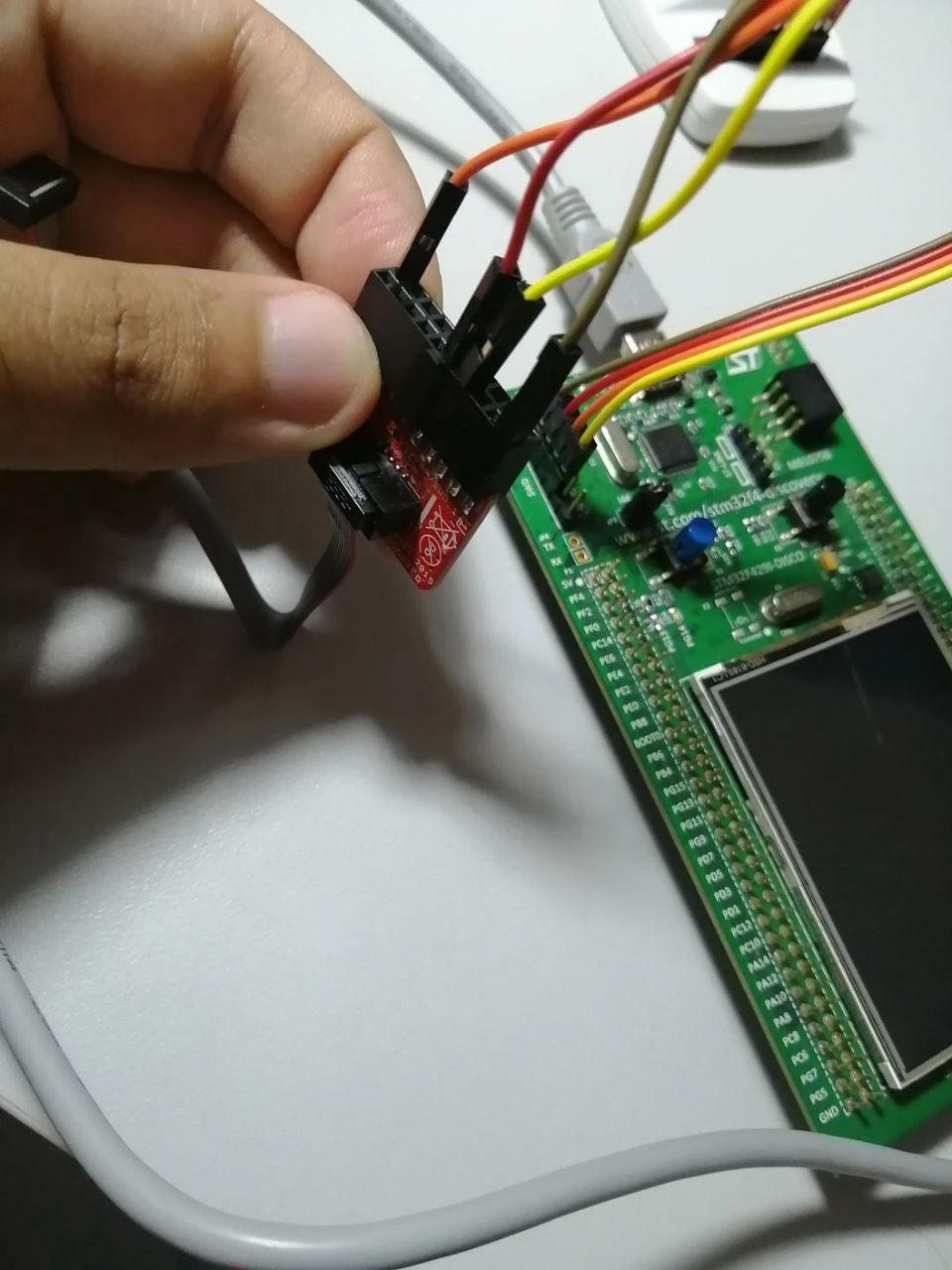

Is my first time working with a custom board and I have:
  • ST-LINK/V2 programmer
  • JTAG 20 PIN 0.1" TO 10 PIN 0.05" ADAPTER
  • Custom board with an STM32F446RCT7TR
I use the adapter to connect the ST-LINK/V2 to the programming port in the custom board.
What I do:
  • Connect the ST-LINK/V2 to the board
  • Connect the ST-LINK/V2 to the PC
  • Power on the custom board
  • Go to the STM32CubeProgrammer
  • Finally connect to the board
All I get is an error: No STM32 target found.

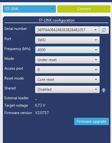

Attached is the configuration I'm using (I tried almost all of them)
12:47:06 : ST-LINK SN : 36FF6A064246363828481057
12:47:06 : ST-LINK FW : V2J37S7
12:47:06 : Voltage : 0.74V
12:47:06 : Error: No STM32 target found!
12:47:09 : ST-LINK SN : 36FF6A064246363828481057
12:47:09 : ST-LINK FW : V2J37S7
12:47:09 : Voltage : 0.83V
12:47:09 : Error: No STM32 target found!
12:47:13 : ST-LINK SN : 36FF6A064246363828481057
12:47:13 : ST-LINK FW : V2J37S7
12:47:13 : Voltage : 0.83V
12:47:13 : Error: No STM32 target found!

> Voltage : 0.74V
You sure the power is okay? Looks like your board only has 0.74V, which of course is not enough.
Also note that "under reset" won't work unless you have NRST hooked up as well. But you don't necessarily need that.
Tesla DeLorean
Guru
August 1, 2020
Check voltage on Pin 1 or 2 of the 20-pin header. The external ST-LINK/V2 expects you to power its buffers.

I could check that the custom board is getting an output of 3.3V when the ST-Link/v2 is disconnected, however, when I connect the ST-LINK/v2 with the adapter, the voltage drops to 0.3v - 0.6 (more or less the values that the STM32CubeProgrammer is showing in the log messages).
I also measure voltage in the ST-LINK/v2 while it was disconnected from the custom board, output was 1.57V, then it drops to the 0.3-0.6v when I connected to the custom board. Always checking pin 1 or pin 2 of the 20-pin header.
I have an STM32-Discovery board (32F429IDISCOVERY) which also have an ST-LINK/v2 embedded to the board so I detached the CN4 jumpers and connect the JTAG 20 PIN 0.1" TO 10 PIN 0.05" ADAPTER to it, then to the custom board, I measured voltage but here it was also low voltage values in the pins 1 and 2 from the 20-pin header. Here I only connected to VCC, SWDIO, SWCLK and GND. However, in the STM32CubeProgrammer, states that the voltage measured by the logs was of 2.90V...

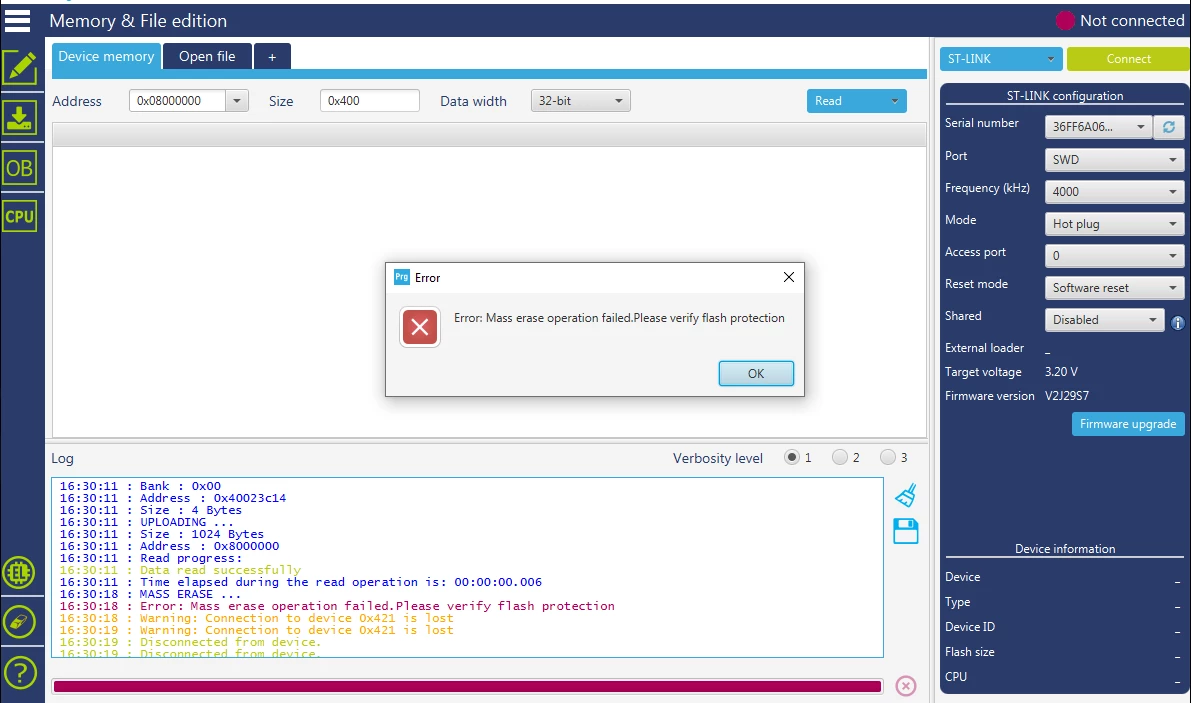

After flipping the SWD connector in the custom board, I was able to detect the board in the STM32CubeProgrammer (FINALLY!) but I have problems programming and erasing the chip.
And this is the setup in the CubeProgrammer:
Port: SWD
Frequency (kHz): 4000
Mode: Hot plug
Access Port: 0
Reset mode: Software Reset
Shared: Disabled
Firmware version: V2J29S7
Every time I try to erase the chip I get the following
16:30:10 : ST-LINK SN : 36FF6A064246363828481057
16:30:10 : ST-LINK FW : V2J29S7
16:30:10 : Voltage : 3.21V
16:30:10 : SWD freq : 4000 KHz
16:30:10 : Connect mode: Hot Plug
16:30:10 : Reset mode : Software reset
16:30:10 : Device ID : 0x421
16:30:11 : UPLOADING OPTION BYTES DATA ...
16:30:11 : Bank : 0x00
16:30:11 : Address : 0x40023c14
16:30:11 : Size : 4 Bytes
16:30:11 : UPLOADING ...
16:30:11 : Size : 1024 Bytes
16:30:11 : Address : 0x8000000
16:30:11 : Read progress:
16:30:11 : Data read successfully
16:30:11 : Time elapsed during the read operation is: 00:00:00.006
16:30:18 : MASS ERASE ...
16:30:18 : Error: Mass erase operation failed.Please verify flash protection
16:30:18 : Warning: Connection to device 0x421 is lost
16:30:19 : Warning: Connection to device 0x421 is lost
16:30:19 : Disconnected from device.
Do you know what could be the issue?

Flashing fails, I'd probably double check the supplies, and voltage / capacitors present on the VCAP pins.

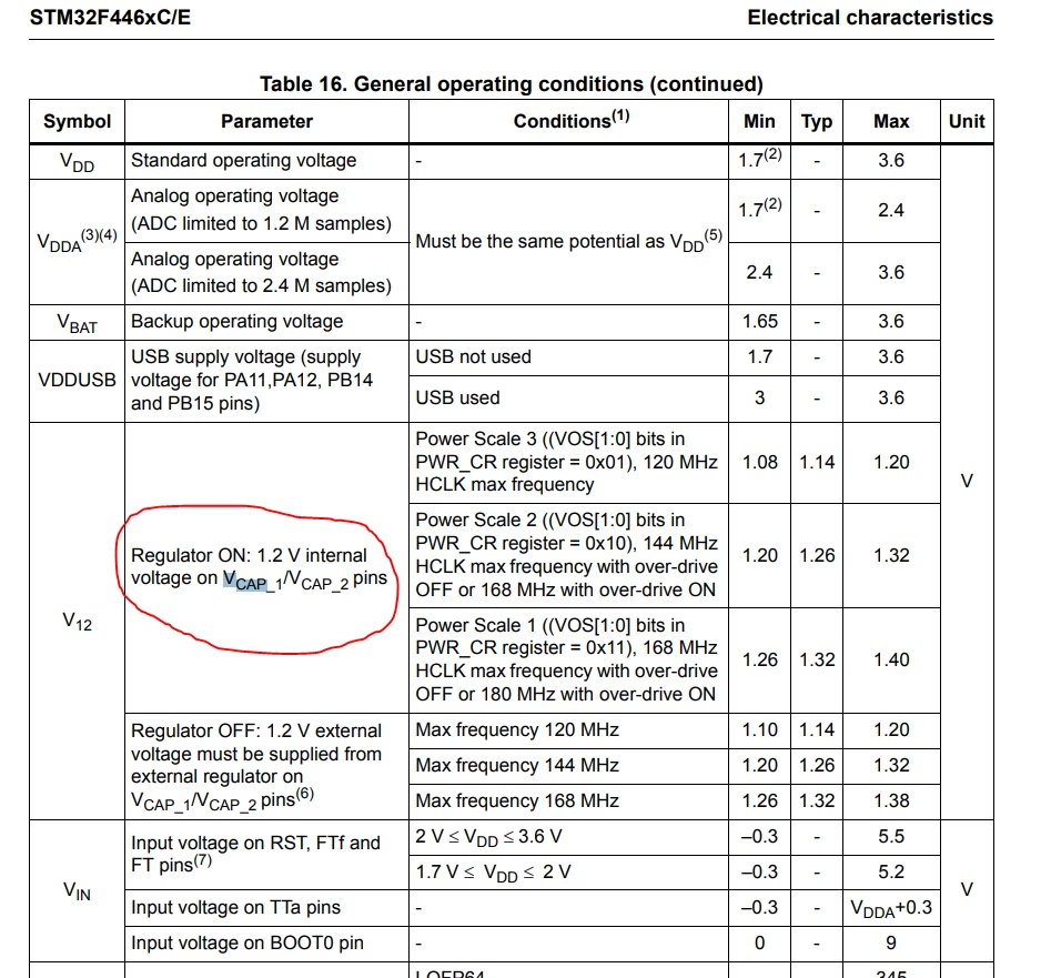

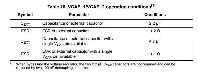

I tested the supplies, my custom board receives 12VDC and then is converted to 3.3V for the STM32. This is expected
Checked the supplies and I'm getting 3.3VDC in the SWD lines.
in VCAP_1 pin I measured 1.32 VDC.
Reviewed the STM32F446 datasheet but I am not actually understanding it well, but I guess the VCAP values are good.
However, I've found in the schematics that the VCAP uses a capacitor in my custom board:
GRM31CR61E476ME44L which looks like it is 47uF and it should be of 4.7uF . Not sure if this should be something interesting to look and if there is a way to solve the issue. 0693W000003PC47QAG.png
Is it possible damaged? I'm honestly getting without options.:sad_but_relieved_face:
Replace the capacitor(s) with appropriate value
I don't think the wrong VCAP here will cause permanent damage.
