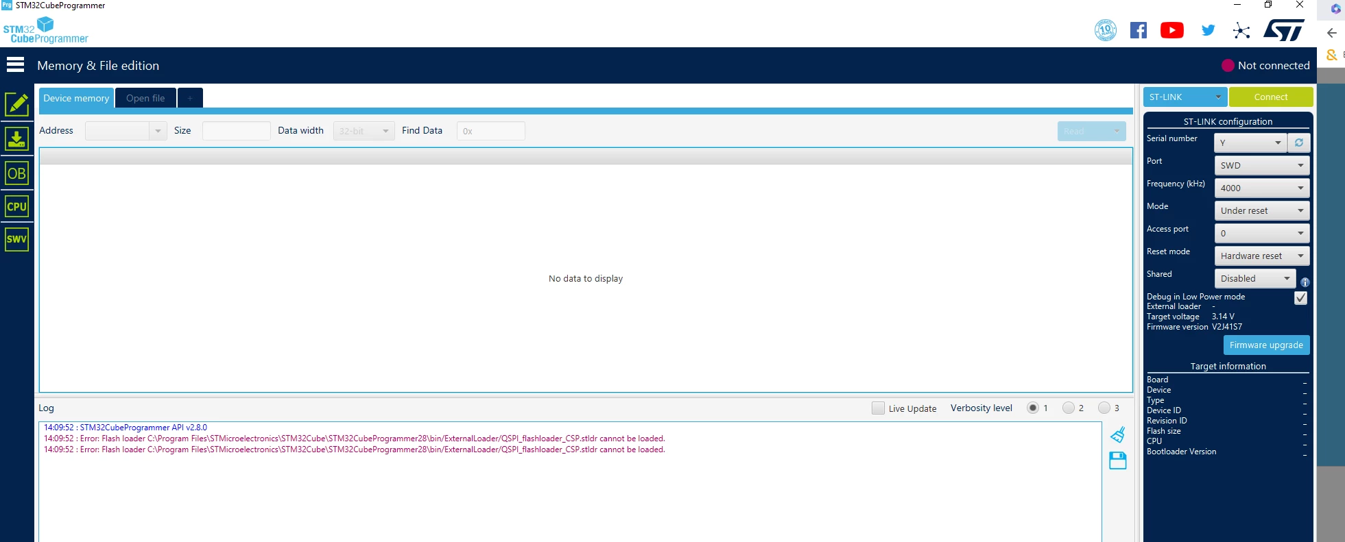

I am able to program my microcontroller with stm32cubeide as shown below
but when I try to program it which the same version of stm32cubeprogrammer I am not able to do it..
I click on connect but nothing happens..
Which are the differences with the previous st link h?

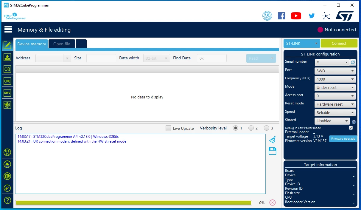

Hello @SGasp.1​,
Could you do the same test with the latest STM32CubeProgrammer release (v2.13)?

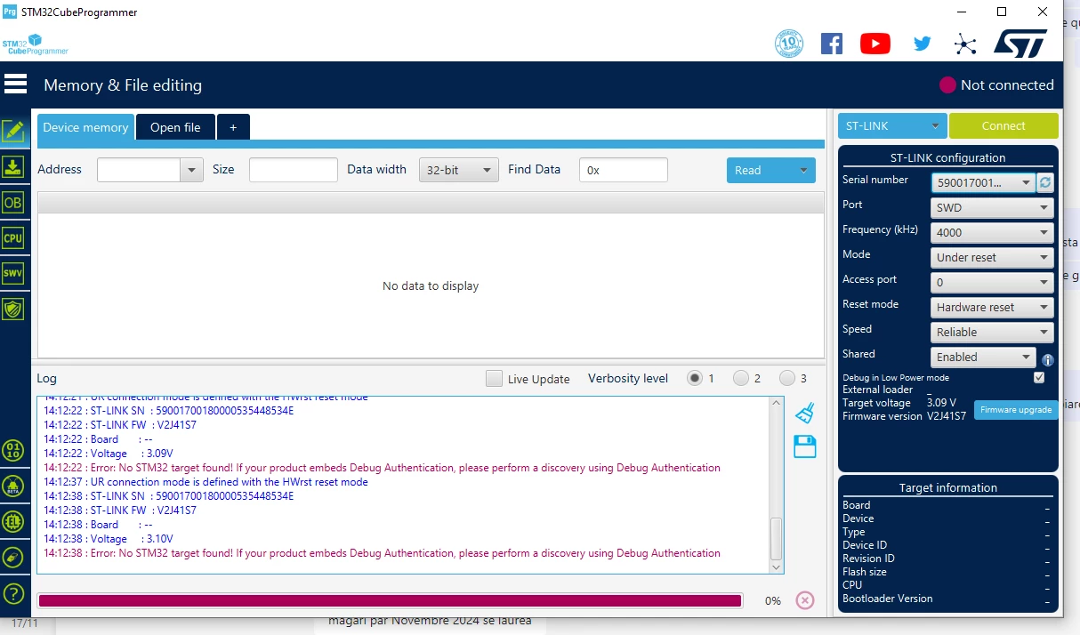

Here the result of the update
Any idea about the issue?

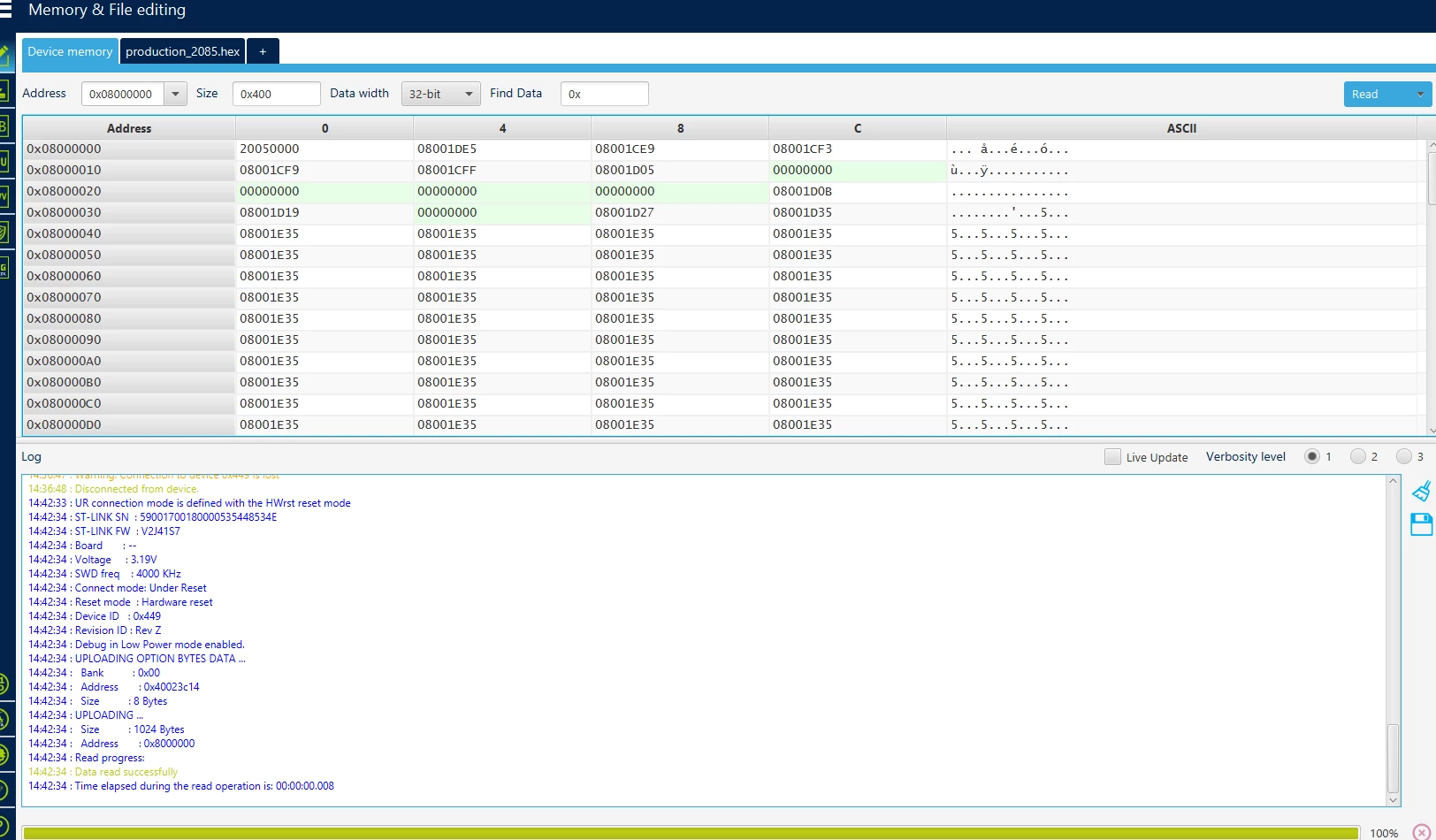

_legacyfs_online_stmicro_images_0693W00000bkBmaQAE.pngI was able to read the flash by changing the shared option from disable to enabled (using 2.13 version)

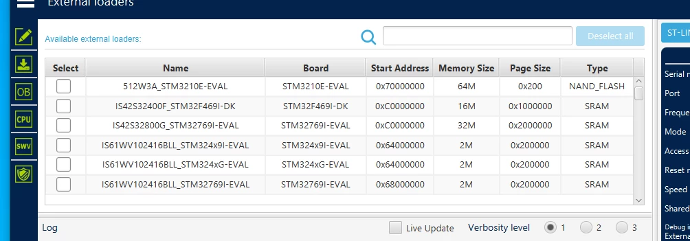

Now I want to try to download the fw but I have also an external loader too named QSPI_flashloader_CSP.stldr . I have added my custom bootloadr inside the externalloader folder under the 2.13 directory but i am not able to see it in the gui .
What could be wrong ?

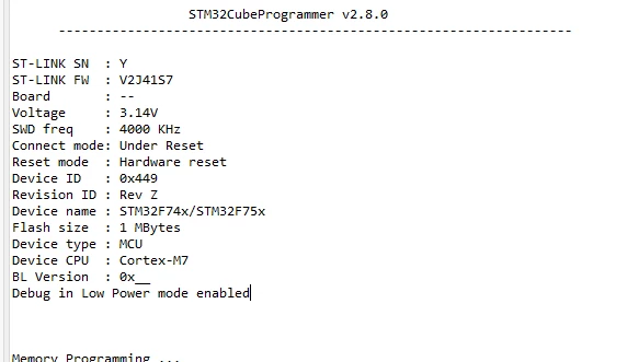

It probably doesn't work with the newer version either, so you can assume that your ST-LINK/V2 is a fake from Asian production. You can already tell from the serial number, which only gives a letter (Y in this case) instead of a real serial number.
The problem with such fakes has already been discussed very often in the community, e.g. here. The only solution is to buy an original ST-LINK/V2 from an authorised dealer, but you won't find them on Alibaba, Ebay or other cheap sellers.
