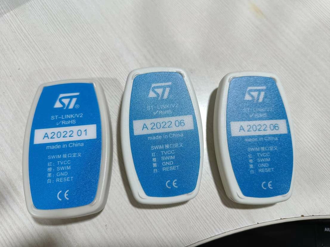

HI Everyone
I have ST-LINK/V2 . its working with STM32 ST-LINK Utility V4.6.0
But whenever I using ST-LINK/V2 with STM32Cube Programmer V 2.8.0. ST-LINK/V2 not detect and not able to download program Even STM32cube Programmer can't recognized either ST-LINK/V2 connected or not.
#STM32CubeProgrammer​
#ST-LINK
Please Help Me

Peter BENSCH
Nov 14, 2022 12:54 PM UTC
Welcome, @KJagt.1​, to the community!

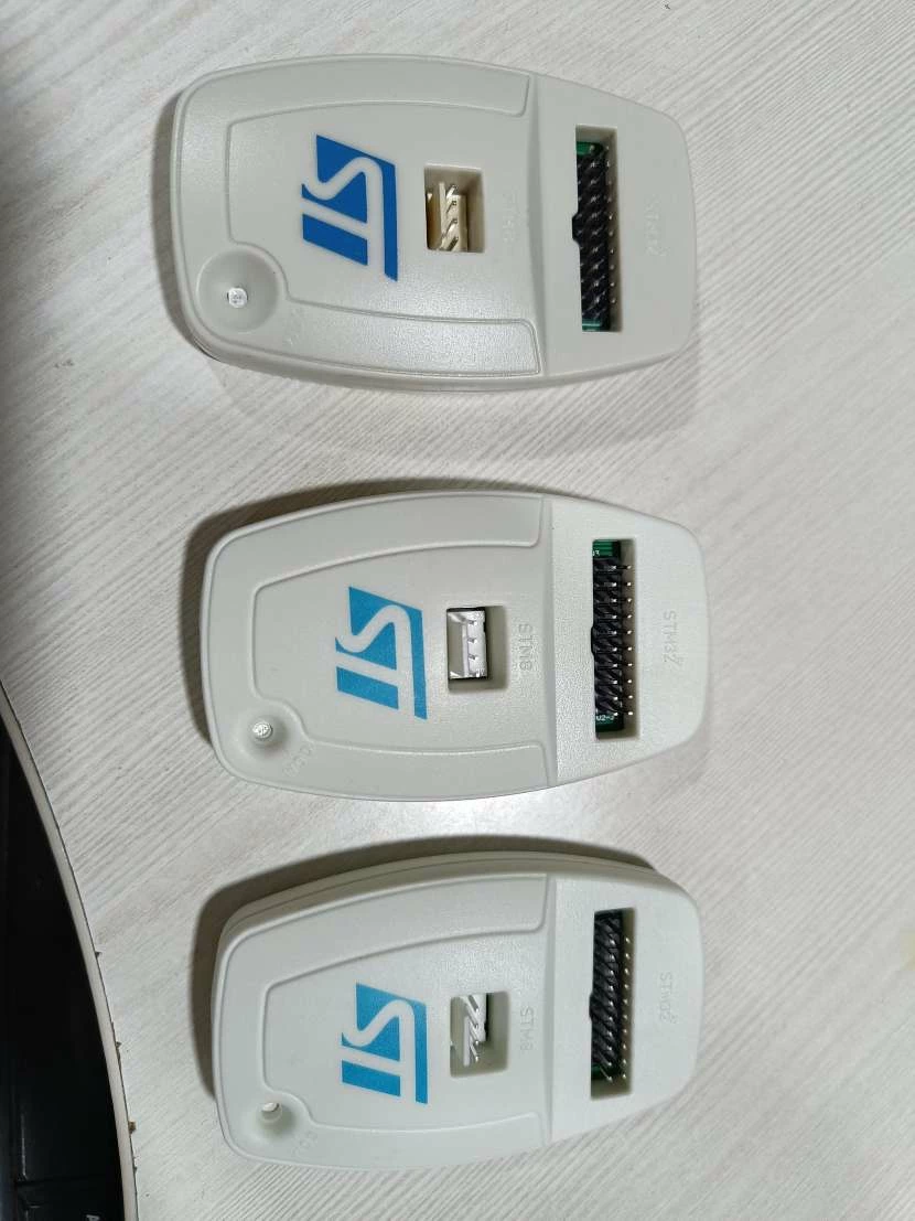

Could you please add a photo of your ST-LINK/V2 here, preferably with front and back?

Peter BENSCH
Nov 14, 2022 1:19 PM UTC
Thank you, they look ok.
Can you please upgrade your STM32CubeProgrammer to the latest version and check again?

Mike_ST
Nov 14, 2022 3:42 PM UTC
From pictures, and because they are not working, there is a high chance those are clones.

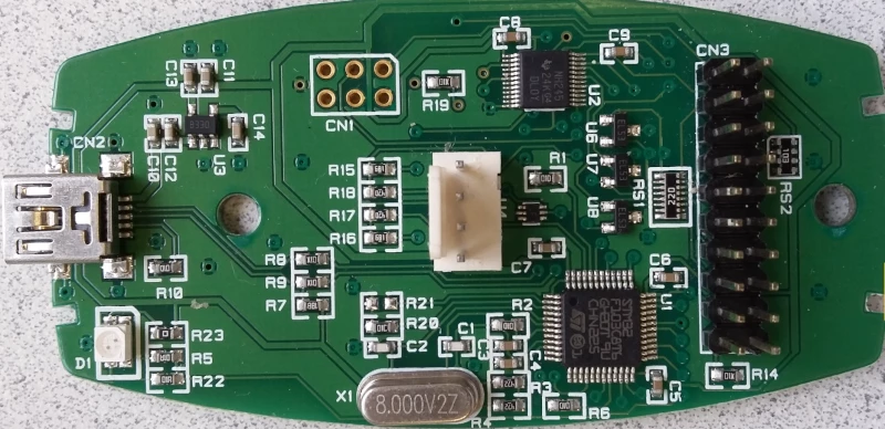

AScha.3
Dec 2, 2022 7:42 AM UTC
>But i orded 3. 2 out of 3 working fine with stm32cube Programmer
so just one is defective. buy a new, or give back for exchange.
or open the not working one and : it look like this original ?
show a good pic - if possible.
Peter BENSCH
Mar 2, 2023 1:23 PM UTC
Update: meanwhile there is a knowledbase article on the topic: How to recognize a genuine ST-Link/V2 versus a cloned one?, created by Amel NASRI.
