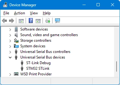

Hello all !
I have just purchased from the ST Micro web shop an STLink V2. I need this to change the firmware on a Dragino LAQ-4 air quality monitor, as recommended by Dragino.
In order to perform this upgrade, the ST Link has to be used with the STM32Cube Programmer, via the UART option.
The problem I am facing is that the Cube Programmer, when I select UART, shows No Comm port selectable.
I run Windows 11 Home and, in the Device Manager, the ST link is correctly identified under Serial Bus Devices as STM32 STLink with no warning sign next to it.
I have tried re-installing drivers, downloading STLink 009 driver package and installing that.. nothing works.
If I use the Cube Programmer, I can update the firmware of the ST Link itself with no issue. I have used the STLink utility (004) as well for upgrading and downgrading the STLink V2 firmware, again with no issue.
The STM32Cube Programmer would not see it under UART and in Device manager, there is no Com port allocated.
If I try to create a legacy port and go through the process and select ST Microelectronics Virtual port, the port created is there and selectable but unusable as Windows says: cannot start (error 10).
I am looking for some ideas and suggestions, please, if you have!
All the best!
Because, if I'm not terribly mistaken, there is none:
https://www.st.com/en/development-tools/st-link-v2.html
Later V2-1 variants have this UART port (USB-Serial), but the original V2 version not.
https://stm32world.com/wiki/ST-Link

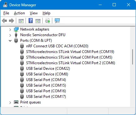

Andrew Neil
Jun 26, 2025 9:25 AM UTC
@NDrag wrote:
the ST link is correctly identified under Serial Bus Devices as STM32 STLink with no warning sign next to it. t!
You mean under Universal Serial Bus devices?
That is just the SWD/JTAG/SWIM debugger part.
If it did have a VCP, that would appear under Ports (COM & LPT):
(I have several connected).
