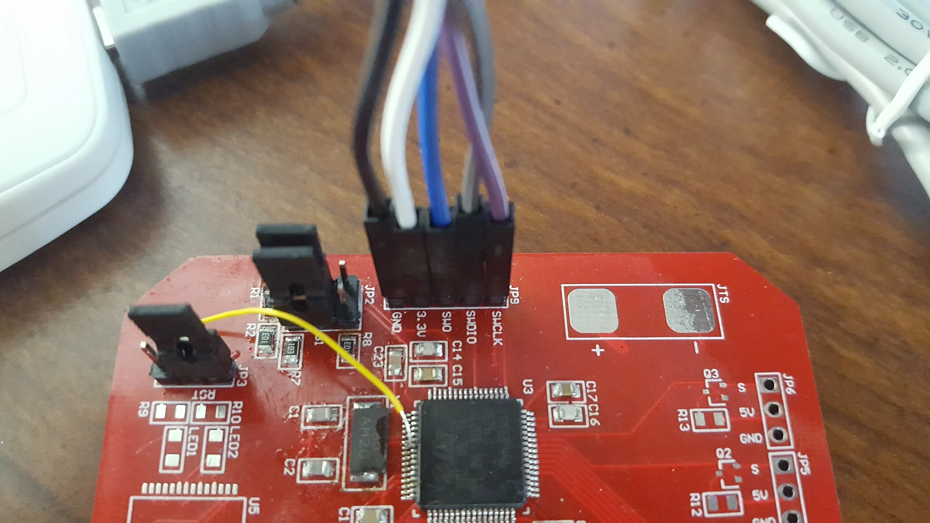

So I made a custom STM32F446RET6 board and I first used a mini ST_LINK programmer to connect to the MCU. I was able to program it but couldn�t debug it since the mini ST_LINK programmer doesn't have the SWO pin. I used STM32 ST-LINK Utility and Keil to program the chip.

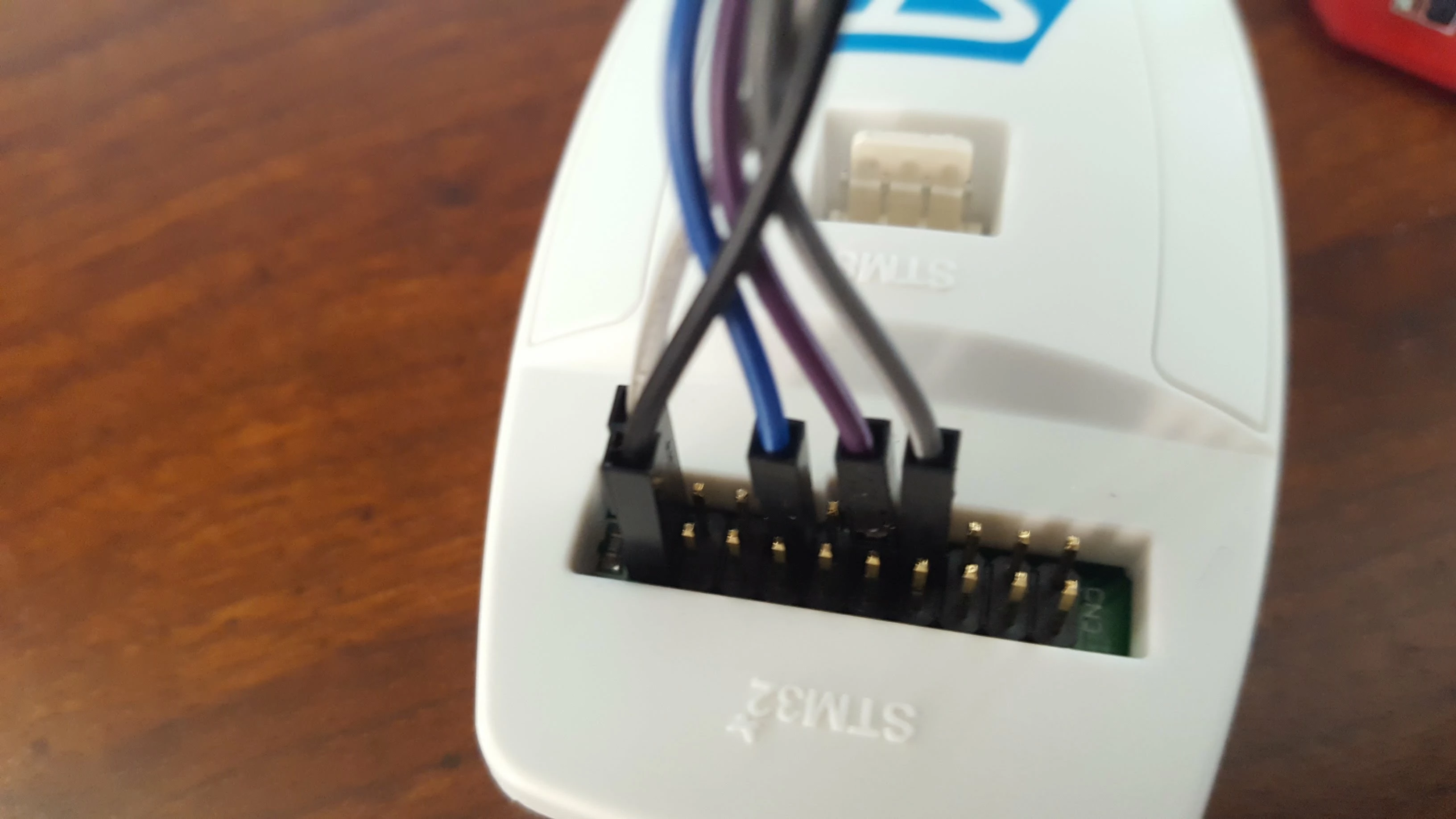

I then purchased the ST_LINK V2 programmer from ST but it doesn�t connect to the MCU (target). My laptop does recognise the ST_LINK V2 programmer since I have the stsw-LINK009 software installed. The SWCLK. SWDIO, and SWO pins are directly connected to the male headers as seen in the pictures.
Here are the Connections:
I also attached the trace.log file from STM32 Utility:

Review the schematic, the error suggests the chip isn't running, or is wired up wrong.
Check voltage observed on NRST and VCAP pins.

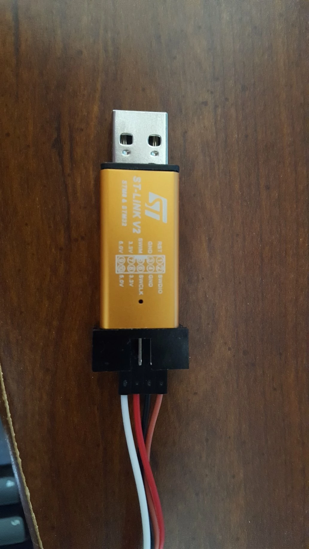

I find the connection was Not correct on ST-LINK V2 side.
Andrew Neil
December 29, 2017
Posted on December 29, 2017 at 14:49
Note that what you show there is not an 'official' ST product - it is a cheap chinese knock-off.
I have noticed with these that the target connector pinout can differ from one item to another - so check the markings on the case carefully ...
