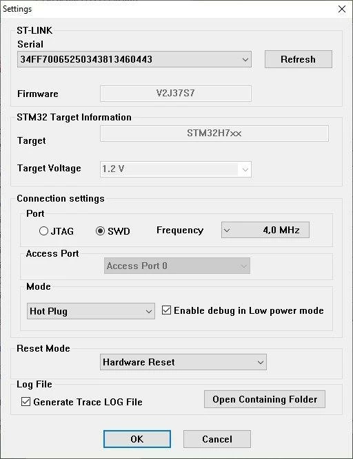

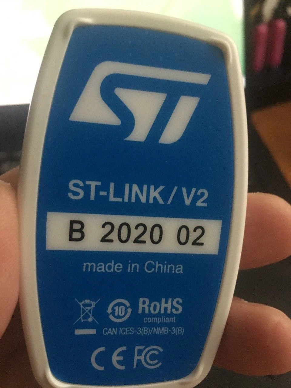

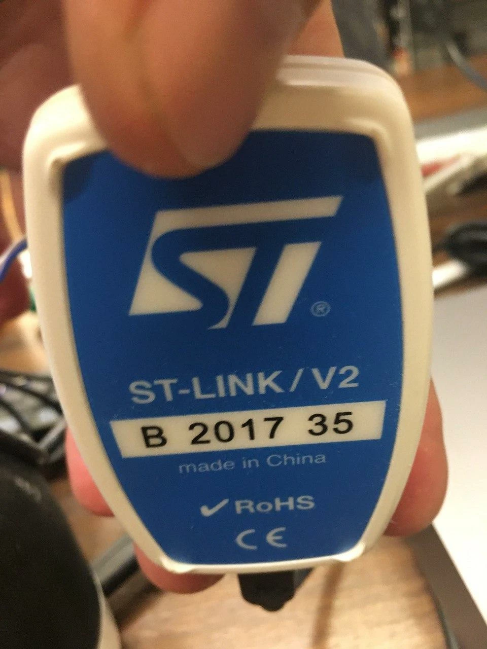

Hi
I have bought two different ST-LINK/V2 devices: one has mark "EN Version" and another has "CN Version". Works only "Cn Version":0693W000003PwLsQAK.jpg
Another doesnt work.
Settings for connection (other settings cant make a connect to device). Vdd on MCU i measure independently - 3.3 V0693W000003PwOhQAK.jpg

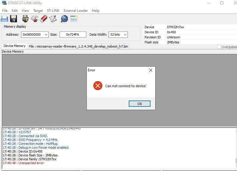

Error message on programming:
I have updated firmware of devices in ST Link Utility to the latest of available. I use them to program STM32H743 device.

How is it wired up? Pin 1 or 2 connected to MCU Target Voltage?​

1 - to Vdd of my board (3.3V)
7 - to swdio
9 - to swclk
15 - to reset
14 to ground
Yes, pin 1 connected to MCU target voltage.

Not sure I have any real solution here, if the unit measures 1.2V on a pin with 3.3V on it, we've obviously got an issue with the power or grounding.
There are a lot fake/clone units out there.
You could remove the back label and disassemble, review and probe the circuit on the board.
Check if the buffer chips are present, or if it just goes straight into an STM32F103
