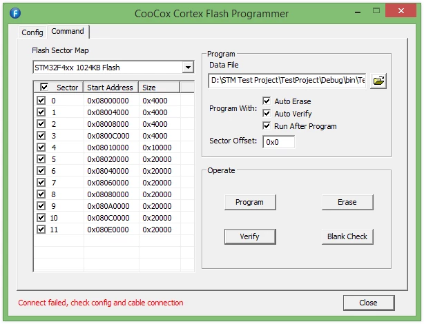

I have updated firmware version of ST Link V2 on my STM32F4 Discovery board, but after this programmer does not work. I have an external ST Link V2 with firmware version ''V2.J14.S3 STM32+STM8 Debugger'' and he is working corectly. Where can I download this version?

You're perhaps going to want to try the BOOT0 HIGH trick. Or HWRESET option
/public/STe2ecommunities/mcu/Lists/STM32Java/Attachments/1453/cooflash_stm32f4disco.gif
________________
Attachments :
cooflash_stm32f4disco.gif : https://st--c.eu10.content.force.com/sfc/dist/version/download/?oid=00Db0000000YtG6&ids=0680X000006Hz9Z&d=%2Fa%2F0X0000000bMU%2FEtuwTNSB46N98TNf7vpL.z8s4s3CbijLgEl8pqmMaEM&asPdf=false

No. I already was trying this way...

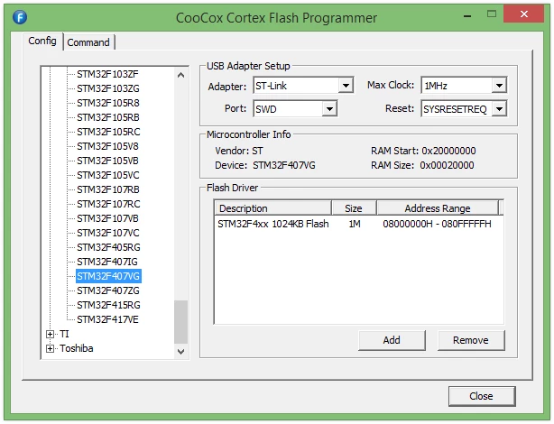

Hi Happy.cool,
Please Try to connect with ST-Link Utility tool and send me the error displayed.
This can help to know whether the connection fails with the ST-Link or Target.
You can find in the following link the latest version of ST-Link Utility :
http://www.st.com/web/en/catalog/tools/PF258168
Please make sure that jumpers on CN3 are fitted.
