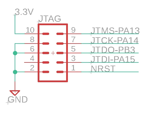

ST-LINK/V2 Failed to detect STM32F446RC on custom board with pin headers shown in images.
Hi!
I am currently trying to connect the ST-LINK/V2 to my custom board which is using a STM32F446RC. I am able to detect the ST-LINK using both the STM32CubeIDE or the STM32 ST-LINK utility, however this is only displaying the serial number. but it is failing to detect the target (MCU).
I have added a picture of the header on the custom board and the header am using for guidance.
Am not sure whether to use the JTAG connections or the SWD connection guidelines.

Seems like your pin numbering is completely rotated vs ARM 10-pin
Just use the SWD connections, the ST-LINK expects 3.3V on Pin 1 or 2 of their header
GND, VCC, SWDIO/TMS, SWCLK/TCLK minimum
NRST allows for connect under reset
SWO/TDO allows for debug channel
Check orientation of your STM32
Make sure VDDA is powered
Check voltage/caps of VCAP pins, should see 1.25 V or about
Check level on NRST, should be high

@Community member​ Thank you for replying. So I tried connecting it using the SWD connections. I have attached a picture of the table I used for connection. the SWO pin would be PB3 on the custom board header. Everything else maps the same. I still receive a fail connection.

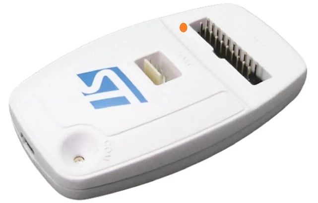

Tesla DeLorean
Guru
September 21, 2021
Suggests you're not connecting the target VCC to pin 1 or 2 of the ST-LINK JTAG header, or your device isn't powered. Orange Dot is Pin 1 location
September 21, 2021
What "ST-LINK/V2" are you using exactly? How exactly do you have wires going from that to your target board?
