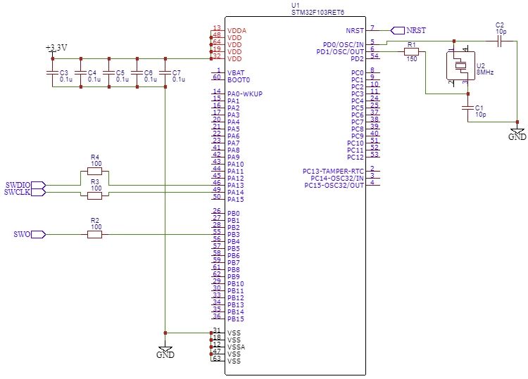

I have a custom STM32 board which has basically only the needed components to flash and use an STM32F103RET6 on board. This means, there are only a few capacitors for voltage stability, an 8MHz quarz + circuitry, and a few connectors on it.
I have the SWDIO, SWCLK and NRST lines connected through a 100 Ohms resistor exposed so a connector, so I can use them to program the device.

So I set up a logic analyzer and found out, that the device is actually communicating with my ST-LINK.
It is basically doing this:
  1. Line Reset
  2. Read IDCODE (successfully)
  3. Wants to write to CTRL/STAT (gets ACK WAIT as response)
  4. Line Reset
  5. Repeat 1-4 ca. 100 times
  6. Read IDCODE
  7. Read from CTRL/STAT (successfully, response: 0xF0000000)
  8. Somehow stops doing anything and throws the error mentioned above.
My BOOT0 pin is floating, if that is of interest.
I have no idea how to proceed from here. I cant even connect to the device, however, the device is clearly communicating with the chip.
I checked a chip of my batch on a Evalboard (Nucleo), and it promptly connected and read the memory. So the chips are not defect.
Do I have to remove any write protection or something which the debug interface does automatically on the Nucleo-Board, or why cant I use my chip at all?

Schematics:

We found the issue.
The Problem was that `VDDA` pin had not enough energy supplied to it.
This means, it was a hardware issue.
To make clear what the actual problem was and why we didnt detect it:
We checked all `VDD(A)` pins and found that every pin had the right voltage supplied. However, in the gerber files we discovered that the `VDDA` pin via was not connected properly to the 3.3V plane. There was a huge resistance (in this case 600kΩ) between the 3.3V rail and the `VDDA` pin. We measured the right voltage at the `VDDA` pin because there was a capacitor and it had enough time to charge up. Thus we measured the correct voltage. However, once the uC started to draw actual power, the cap didnt provide enough energy/current and the uC couldnt start up. That also explained the error message from JLINK "Couldnt start up DAP".
Ergo: `DEV_TARGET_CMD_ERR` is probably a hardware issue.
