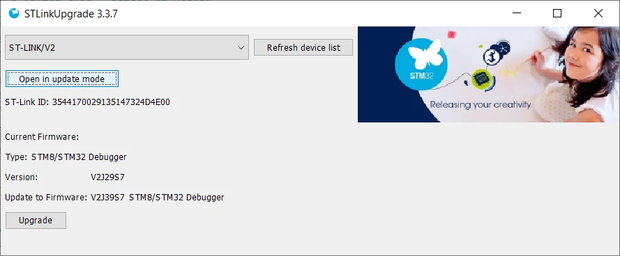

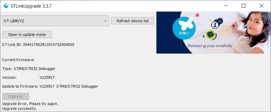

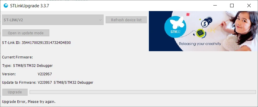

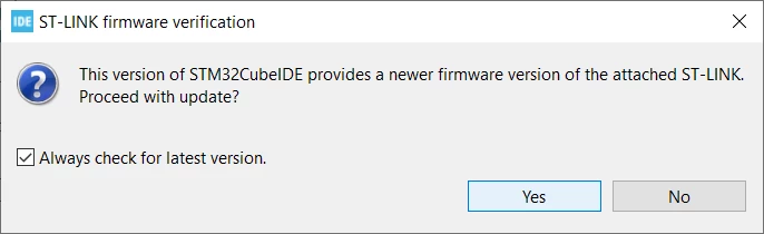

Here is a sequence of screen captures demonstrating the problem I'm encountering (in particular, the firmware version displayed by the software appears to become same as the firmware version intended for upgrade; the upgrade says it failed, but then appears to complete, but does not actually solve the operational issue (subsequent attempt to use the device yields the following message in the console:)
"Error in initializing ST-LINK device.
Reason: ST-LINK firmware upgrade required. Please upgrade the ST-LINK firmware using the upgrade tool."
0693W00000LxQEzQAN.png0693W00000LxQEuQAN.png0693W00000LxQEaQAN.png0693W00000LxQEVQA3.png

Yes, just no experience with this device before --- turns out STM32 Programmer software (current version) supports the clone for programming/reading/etc., but no debugging, which is sufficient for the current need.

Just open your ST LINK V2 and see which ic inside other from ST is clone devices.​

Clone is equipped with CKS 32F103C8, seems to be a non accurate alternative to STM32F103C8.

Agreed - I did find that type of device inside the clone unit; I now use STM32CubeProgrammer with this device as it is (at least in current version) accepting the clone unit's existing firmware; I use a genuine STLink device when necessary to use STM32CubeIDE 1.9.0 which will not accept nor upgrade the clone unit's existing firmware.
