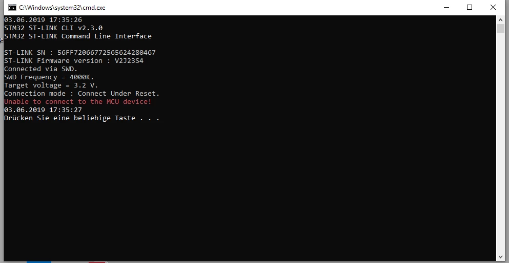

Hey guys,
i'm currently struggeling with the STM32 CLI to programm my MCU.
For my (old) STM32F103 i did setup a script wich worked nicely. Going through the documentation a came uo with
ST-LINK_CLI.exe -c SN=xxxxxx SWD UR -TVolt -ME -P ../my_firmware.hex -V -Rst
https://www.st.com/content/ccc/resource/technical/document/user_manual/e6/10/d8/80/d6/1d/4a/f2/CD00262073.pdf/files/CD00262073.pdf/jcr:content/translations/en.CD00262073.pdf
(See Section 4)
However when i tried to use the same cmommand to flash my STM32F4 it does not work.
The error is
My gues is that the CLI is still looking for the old STM32F103 device. However there's no option to change the MCU type. Could you help me out, do you have any idea how to fix this?

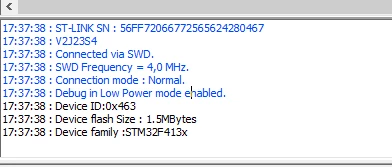

Sorry my bad. I thought i copied the error into my question:
Here it goes:
When i excecute this cmd the MCU is restarted. So "connect under reset" seams to work.
I did try the same using ST Link. The ST Link tool works fine
Output looks pretty much the same to be, except one is working and the other not. :(
As you said, i tried JTAG (with STM32 Link Utility) but this did not work. I'm not sure if SWD and JTAG are hardware compatible though ?!

Try updating the ST-LINK to the latest version (4.4.0.0). It might recognize newer devices.
JHeni
JHeniAuthor
June 4, 2019
Thx that was indeed the right answer. After upgrading mit ST Link CLI the device was found.
Just FYI:
After that i had to face 2 additional problems
  1. "unable to open file" error. => I have been usiing ../my_firmware.hex to set the path. This did (for some reason) not work any more. Removing the ../ solved that problem
  2. The MCU was not restarted after Flashing. I replaced the -Rst with -HardRst. Now the MCU is restarted after a flash
Thx for your fast help :)
