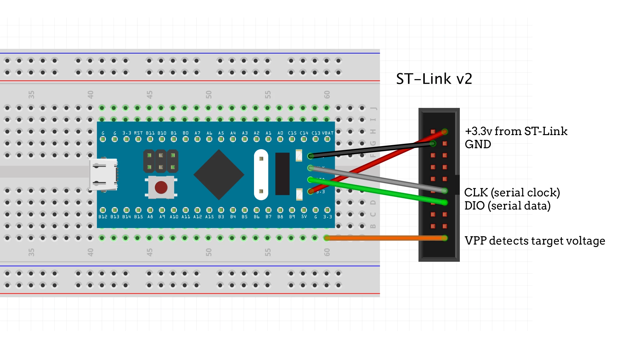

I have bought a new ST-Link/V2 from Digikey a while back and have only recently gotten the chance to use it. But every time I try uploading code to my geniune WeAct F411CEU6 board using SWD I get the error code "Error: No STM32 target found!". I don't think my connections are wrong cause I followed the instructions from this website:https://waterpigs.co.uk/articles/black-blue-pill-stm32-st-link-connection/
The target voltage detected is 3.14V and the firmware version is: V2J38S7.

Connector looks backward and upside down
VPP looks connected to pin 1, not pin 19 where it is supposed to be.
Guess it depend what you're looking at. All the docs show the male pin header, not starring into the female connector. I tend to jumper onto the ST-LINK itself with Schmartboard jumper wires or DuPont ones.
I do. Prove me wrong (i.e. post foto, schematics, etc.)

This is the connection I'm using except for that I am using except for I'm using the black pill instead of the blue pill in this picture.
