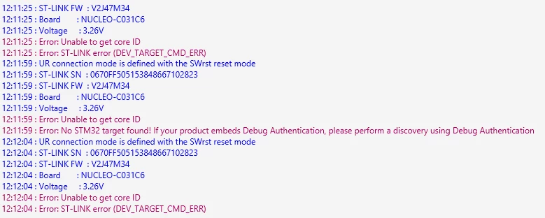

I’m using a NUCLEO-C031C6 64 board.
I successfully setup the tool chain and ran several test from STM32CubeMX templates, directly compile and programming through STM32CubeIDE.
Until this morning, everything was working fine.
But I have lost the connection to the MCU later on.
From STM32CudeIDE:
Target unknown error 19
Error in initializing ST-LINK device.
Reason: Unknown. Please check power and cabling to target.
Using of STM32CubeProgrammer:
  • Recognized as mass storage
  • On board ST-LINK/V2 is recognized, updated to version V2J47M34 successfully
  • Full chip erase and board recognition works fine on the NUCLEO-G031K8 board
But I have repetitively following messages while I try to connect ():
I have tried unsuccessfully:
  • under reset mode
  • external SWD ST-LINK
How can I debug futher?
Did I miss something?
Thanks!

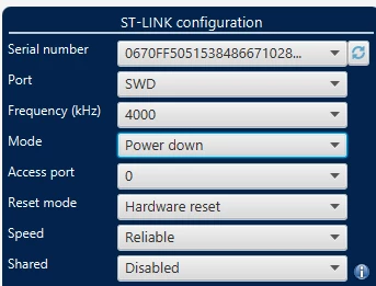

Thanks all for your suggestion.
I tried several reset configuration, both on the board and with CubeProgrammer options.
Everything was normal on the scope from ST-Link side (SWD signal, NRST).
I finally get back access to the STM32 using the option “power down”:
I erased completely the MCU and I can now program it again with CubeProgrammer or directly after compilation with CubeIDE.
Thanks!

Andrew Neil
Jun 23, 2026 10:33 AM UTC
Is your software using low-power modes, and/or reconfiguring the SWD pins ?
Have you enabled any security/protection ?
Try connecting from CubeProgrammer.
Jun 23, 2026 9:12 PM UTC
The program is a basic CubeMX configuration template. I have no low-power mode or security settings.
I played with clock configuration and somehow disabled the “serial wire” debug in one of my tests. Beyond this point, I couldn’t recover the connection with the MCU
Andrew Neil
Jun 24, 2026 7:49 AM UTC
Connecting under hardware reset should get you out of that.
Or use the System bootloader.
