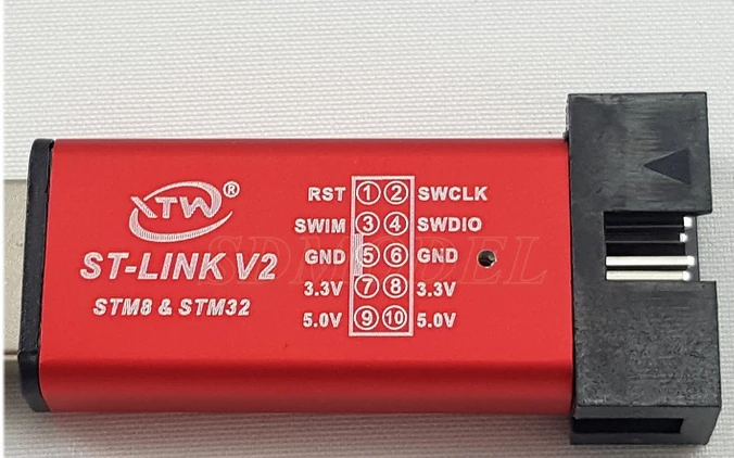

For a connect under reset the ST-LINK drive the NRST signal of the MCU.
On Standalone V2 probe the CN3.15 is driven and should be connected to NRST of your MCU.
Is it the case ?

I am not sure which pin is CN3.15. The ST-Link I have is shown below. RST is connected with my MCU's NRST.
I hope I am not having issues because it is not made by ST. Do you think that's a possibility?
