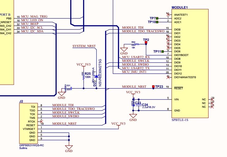

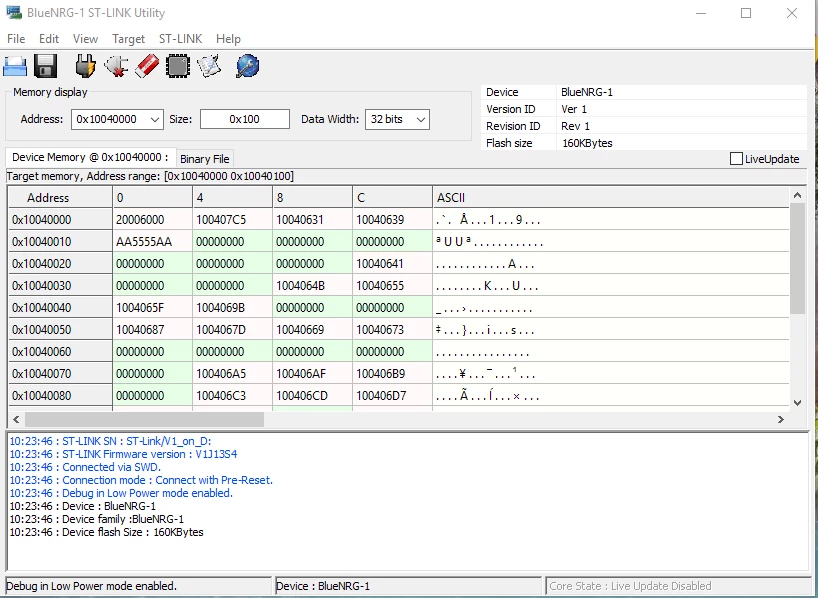

The STM32 ST-LINK V1 connects and recognizes the BlueNRG (see STLINK-V1)
for the ST-LINK V2 and V3, the STM32 ST-LINK Utility connects but does recognize the device. same for the STMCubeIDE debug connection

I have attached the circuit between the SPBTLE-1S and the connector
