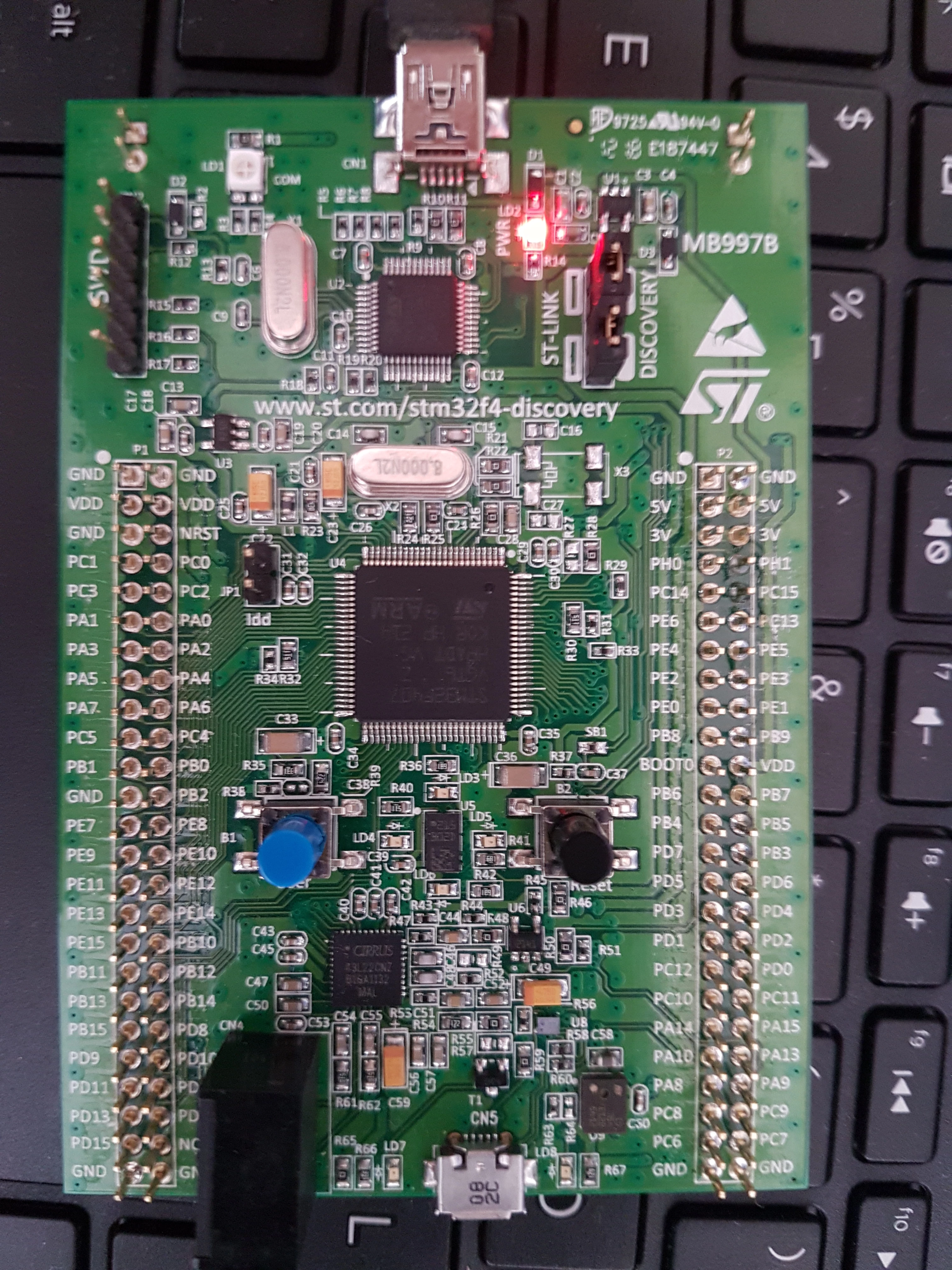

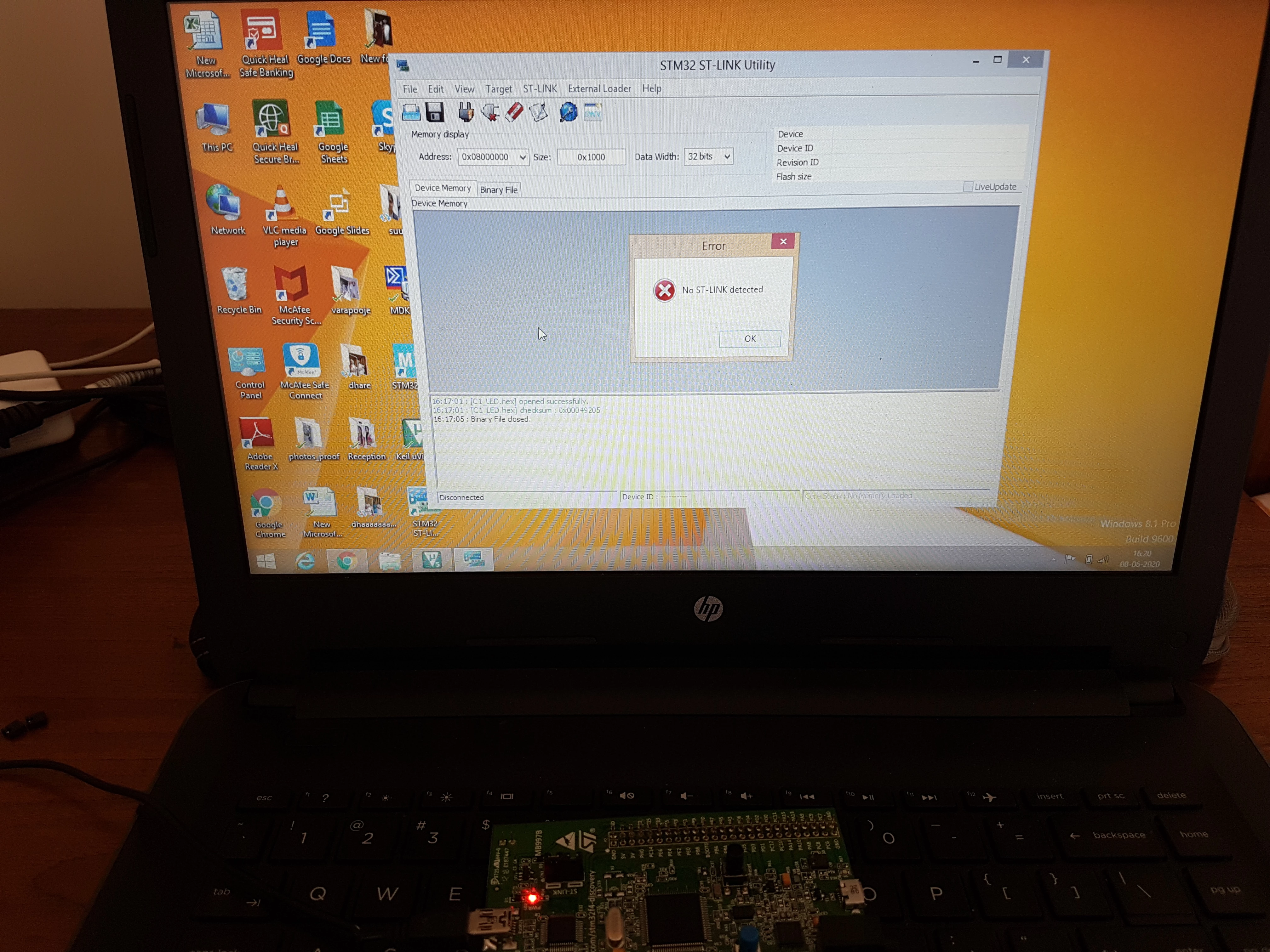

ST Link Utility is unable to detect the board. STN32f407vgt6. It throws No ST - Link detected. I have Windows 8.1, Keil u5, and latest ST -Link STSW LINK004 DOWNLOADED AS WELL. Even Disk Manager methods did not work. Tried hard for that. Pls do help

Is my jumpers in right position. Pls do help. Thanks0693W000001qENCQA2.jpg0693W000001qEMxQAM.jpg

Try a different cable, and USB port.
Keil and ST-LINK Utilities cannot use the pod concurrently. Close Keil to test this.​
Guillaume K
June 8, 2020
also try with STM32CubeProgrammer
