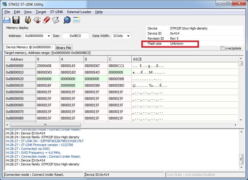

ST-Link Utility. Flash size Unknown
Posted on November 04, 2017 at 12:35
why can not read the volume Flash memory?

Normally pulls value from ROM (OTP). Typically 16-bit word at 0x1FFFF7E0
The F1 parts aren't the primary focus these days..
