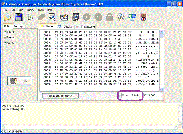

Tesla DeLorean
Guru
October 31, 2014
Posted on October 31, 2014 at 18:05
As posed the question suggests it's the 16-bit or 32-bit sum
0690X0000060MmrQAE.gif Where the coherency of the image can be checked when reading the file, or off the part, and perhaps expressed in the programming file for the Golden ROM
03/25/2011 11:48 AM 131,072 hi8_U20_8bin
03/25/2011 11:48 AM 131,072 lo8_U18_AB7F.bin
2 File(s) 262,144 bytes
0 Dir(s) 402,133,188,608 bytes free
Most of these would be a sum of bytes truncated to 16-bits. Personally I prefer CRC's as the byte ordering would impact them.
