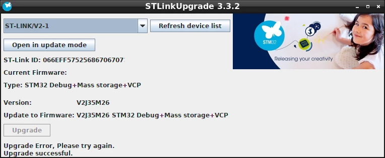

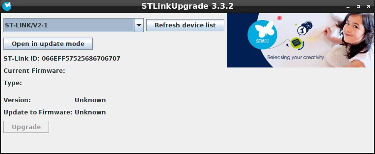

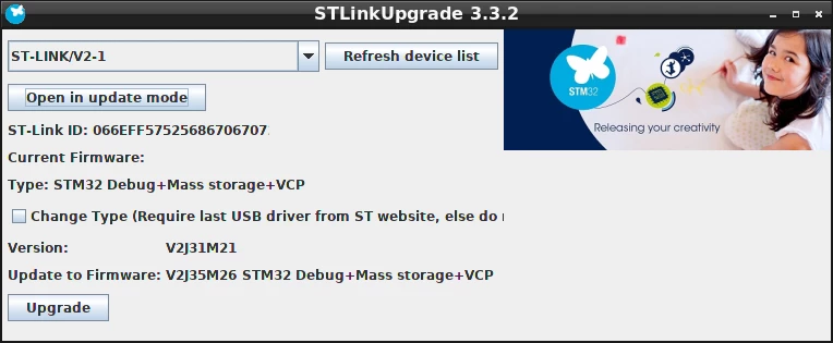

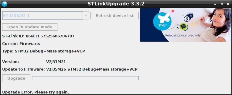

0690X00000ArhEWQAZ.png0690X00000ArhElQAJ.png0690X00000ArhF5QAJ.png0690X00000ArhEqQAJ.pngI would hazard to guess a few images to give a better description, in addition I ran a few tests.
I've given images to show what I am seeing.
I ran the upgrade JAR as root. With the same results (had to do some work using Xephyr to have any output but that is a digression).
However additional output from the CLI was available:
"libusb: error [udev_hotplug_event] ignoring udev action bind
libusb: error [udev_hotplug_event] ignoring udev action bind"
was output when attempting to upgrade.

How I solved this.
The issue was the linux drivers from ST for USB and that specific version of ST-LINK failed to function correctly and or was broken. I am using Debian 10 (buster) 64 bit install, only a few installed applications from source so it was pretty much standard. When I more recently (June) went to use it I had the ST-LINK update utility etc. all updated and installed "the latest" drivers, update was still dysfunctional.
Using a laptop running windows 10 and the windows USB driver that was installed for ST-Link worked without issue. So process of elimination, it's unlikely the JAVA app was different between systems so that only left the Run Time Environment, or the USB driver with that specific version of ST-LINK under linux.
Anyhow it was fixed by bypassing update under linux.
Hope this helps somebody :D
