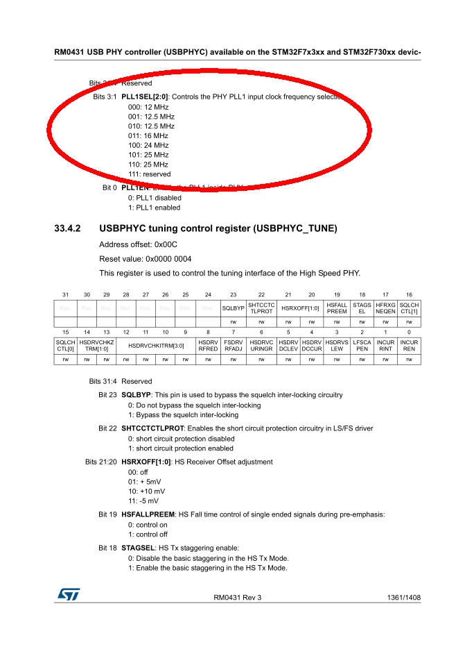

The primary limitation is the USB HS PHY's PLL1:
Yes, they might've chosen 16MHz/24MHz as HSE.
But given status quo, there's nothing much which can be done. MCO1 can be selected between LSE, HSI, HSE, or PLL - and it's PLL/P, the same tap which feeds the SYSCLK itself - and as the primary selling point of STLink3 is the HS USB, there's no way it can run on HSI or HSE instead of PLL. That's it.
And HSI's guaranteed max tuning clock is 1%, so having 8.00MHz+-0.04MHz is the best one could hope for with any sophisticated fine-tuning algorithm. The inherent jitters of HSI included.

They already answered, that clock is selected HSI (16 MHz - F723), and 8 MHz is HSI/2. This makes me wonder, why someone would select 16-HSI if there is 25-HSE and according to picture it's supported by 101 bit settings.
I didn't get "the primary selling point of STLink3 is the HS USB" - subject line of the topic is nucleo-H743zi2, not stlink. Though, StLink here is accessory feature to make primary uCPU -> stm32H743 be fully supported. And HSE input of the H743 demands crystal stable clock be supplied from somewhere (in case local crystal is not installed for cost reduction). Not RC based, there is no point to present 8 MHz for HSE input, it's a non-sense.
One word, backward compatibility. Okay that's two words. There's probably too much example code out there depending on the 8MHz, even if nonprecise. And probably no-one knows, how much and where exactly this dependence exhibits itself.
ST obviously wants to use the STLink3 in all future devboards, even where it does not make sense, potentially replacing STLink2 on existing boards or making new boards for older families, potentially recycling example code.
Should compatibility be dropped, 25MHz is a bit too much to be put through a potentially relatively long track. Div 5 as said above resulting in 5MHz may be perhaps a viable option; I personally don't have problem with any other divider but I'm afraid again the ST tools and "libraries" might not cope with non-integer-MHz clocks well.

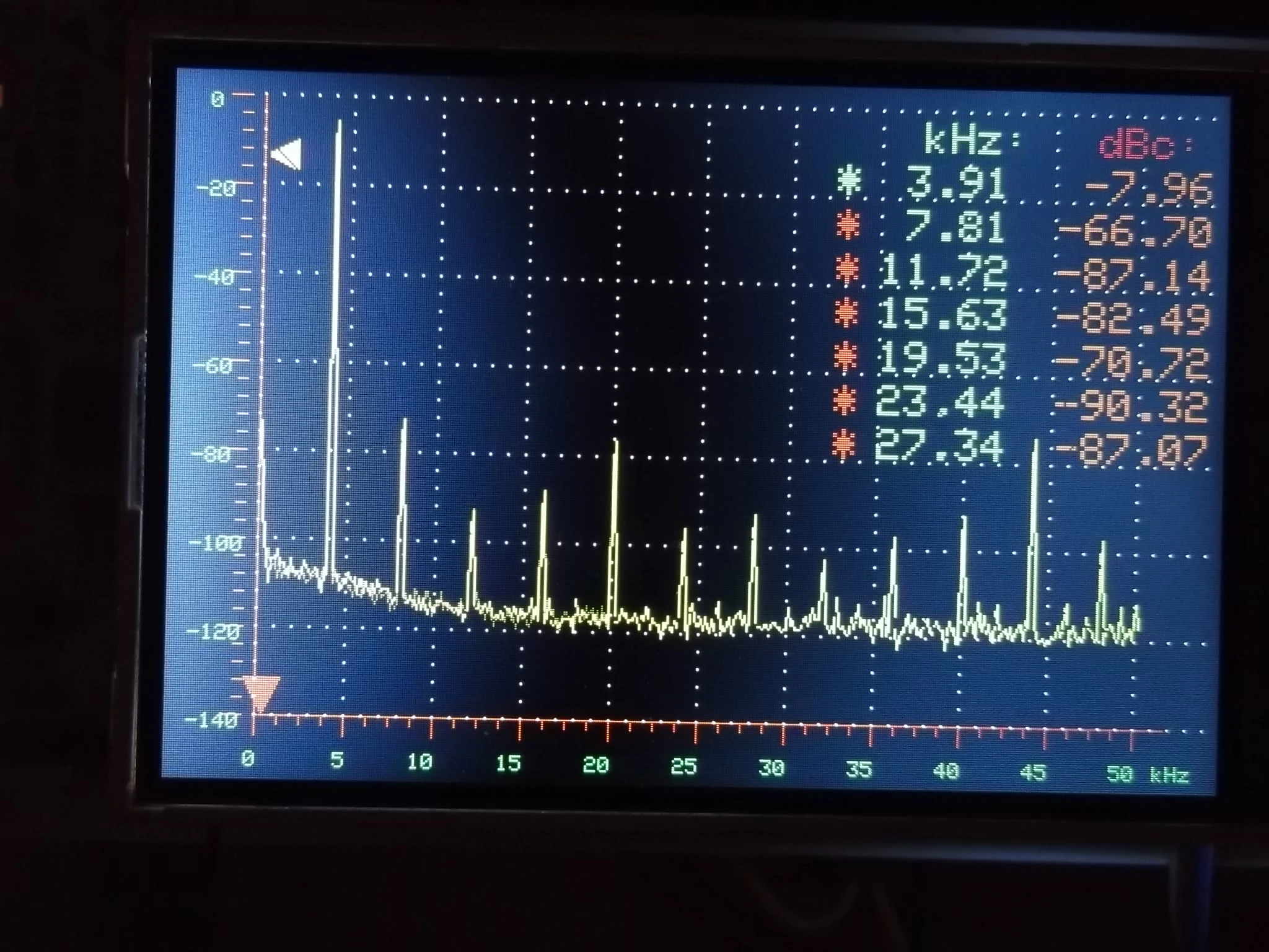

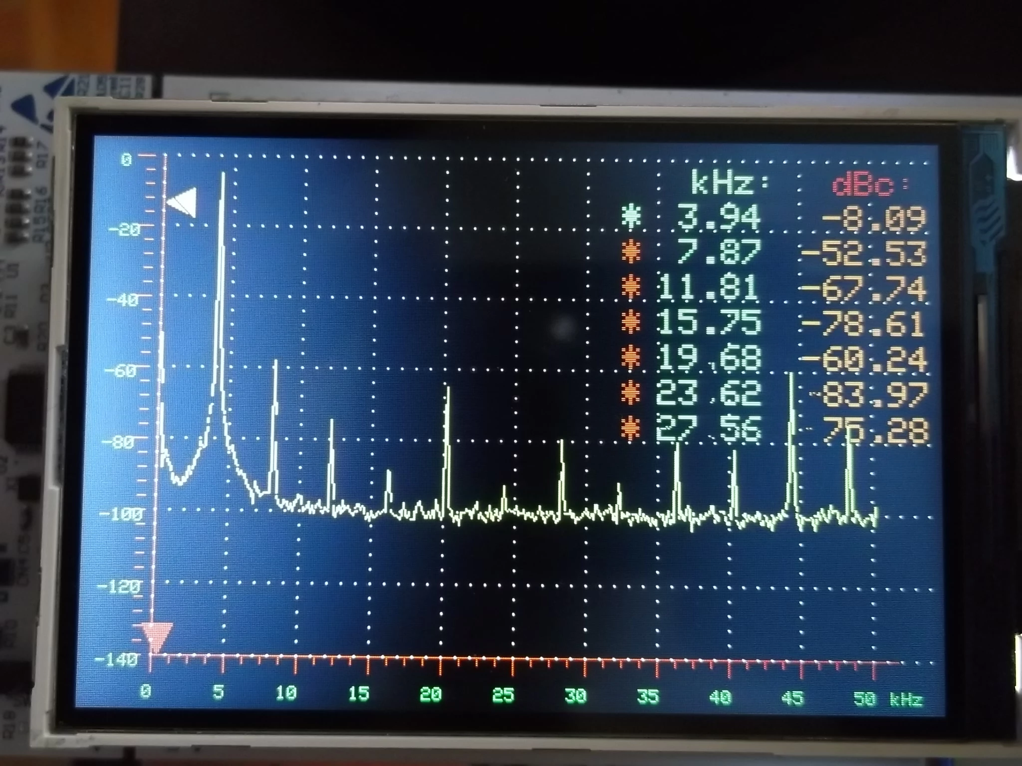

For now I brought 50 MHz from SB57 to SB45 (two pads in close proximity, jumper removed on SB45). Here is the difference:
SA is custom made, still good for "comparative analysis" as long as two pictures taken with exactly the same settings. Picture shows sine signal obtained out of DDS on H743zi2 (two DAC simultaneously 20-bits resolution).
