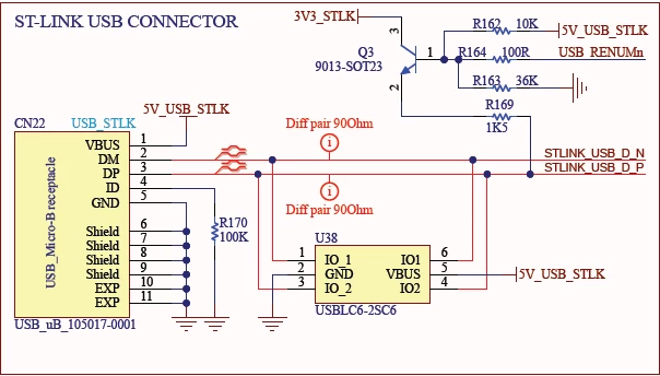

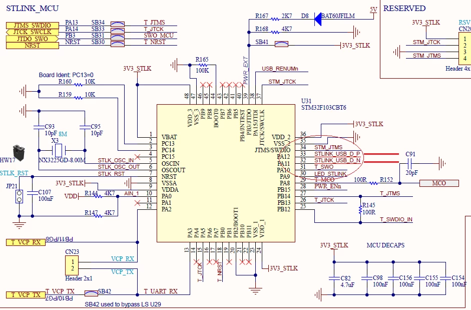

ST-LINK on STM32L552E-EVAL board
I have a evaluation board STM32L552E-EVAL, and I would like to know what is this part used for ?
I see 2 pins (USB_D_N and USB_D_P) that connect to the STM32F103CBT6
What is it for ? To program the component and debug. Thank you for your answer
Regards
Yann DO

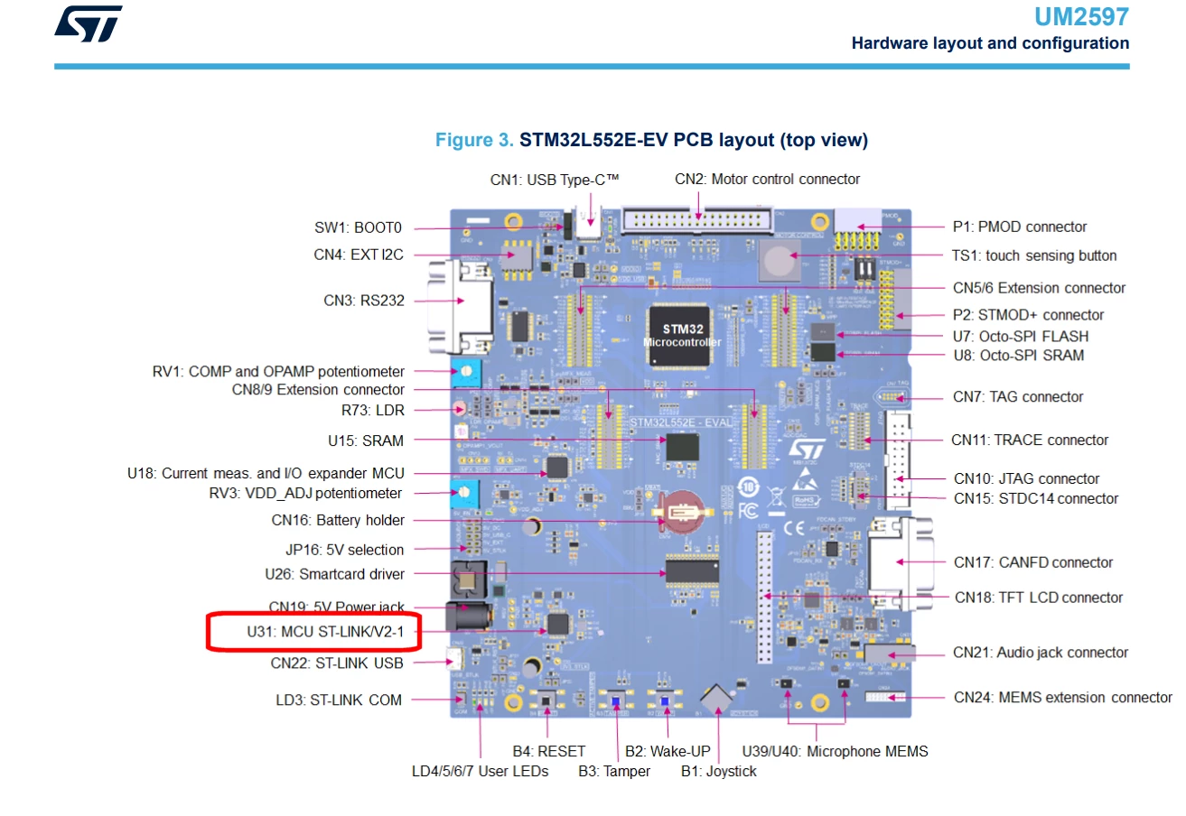

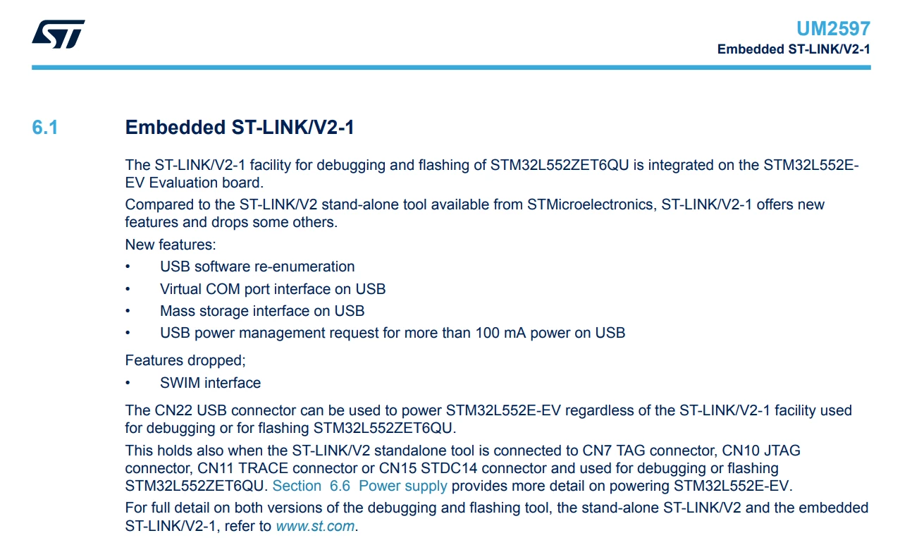

@DYann.1 wrote:
the STM32F103CBT6
What is it for ?
That is the ST-Link - for programming and debugging
https://www.st.com/resource/en/user_manual/um2597-evaluation-board-with-stm32l552ze-mcu-stmicroelectronics.pdf#page=8
via: https://www.st.com/en/evaluation-tools/stm32l552e-ev.html#documentation

Uwe Bonnes
Chief
October 24, 2024
It is ESD protection

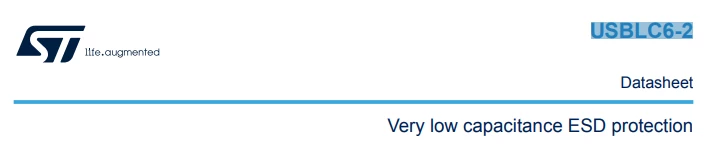

Andrew Neil
October 24, 2024
What part - the USBLC6-2 ?
Its datasheet tells you what it's for:
https://www.st.com/resource/en/datasheet/usblc6-2.pdf
via: https://www.google.com/search?q=usblc6-2sc6
Tesla DeLorean
Guru
October 24, 2024
I'd have thought this would have been readily obvious, the on-board debugger. ST-LINK/V2-1
Provides the USB CDC connectivity to a L552 UART, and an USB MSC to drag-n-drop firmware binaries, as originally used by mbed
