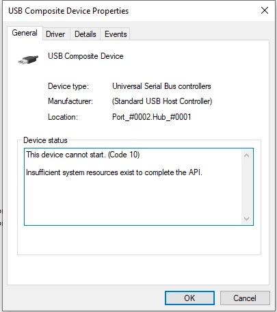

i have bought 3 pcs of STM32L053 Discovery kits and the user USB is working fine with preload demo, but the ST-LINK USB connects to PC as USB Composite Device even if i have download and install the last ST-Link drivers from st.com. I have tried different ports, different cables, also tried reboot computer, reinstall drivers and unfortunatelly nothing helps. Tried all 3 boards and all behave the same.
Other Nucleos (F401, L452, ...) and Discovery boards (L152) are working properly and without any problems.
I kinda desprate.
Thanks for help.

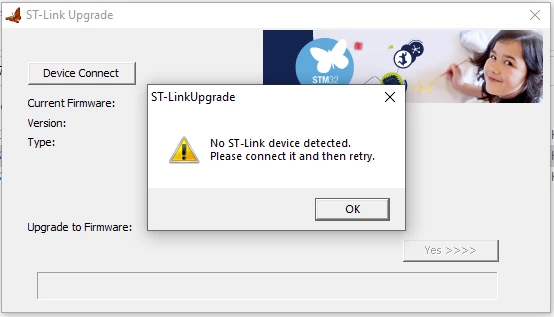

Toximik
ToximikAuthor
January 29, 2022
I get only USB composite device with yellow triangle and no other device appears. ST-Link utility does not see the ST-Link etc.

January 31, 2022
Hi @Imen DAHMEN​,
Setup of jumpers is correct and I don't thing, that any jumper on STM32L053 board have any impact on link between ST-Link and computer.
FAQ is not related to my problem, because I don't have problem with my program, but with the program inside ST-Link chip (STM32F103xx), which doesn't connect to the PC.
