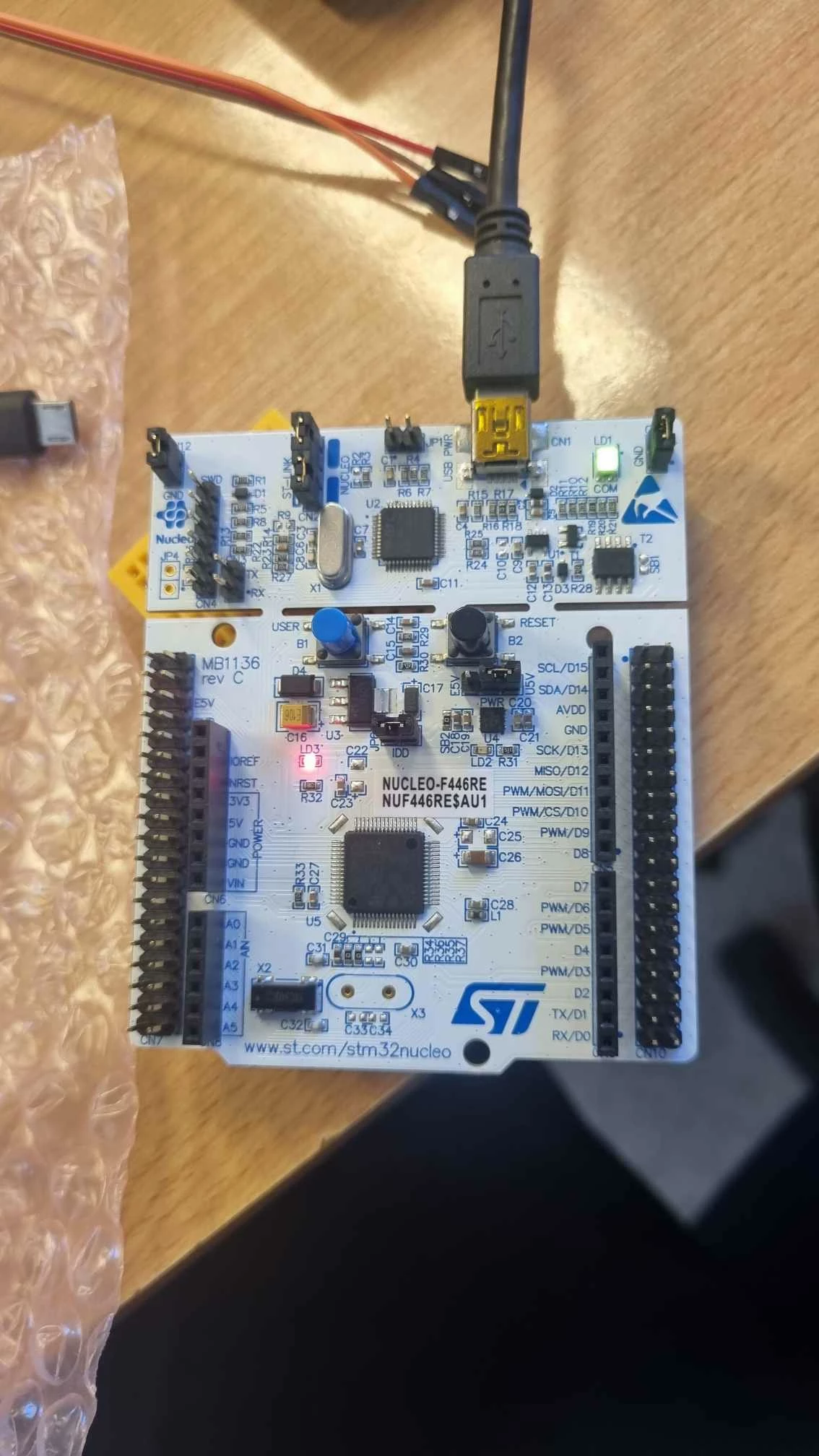

im using th nucleo-f446re board, and the st-link isn't there. Am i missing some jumper connection?438223402_1155287935895863_1986240574336375964_n.jpg

Open Device Manager and turn on the computer sound. When you connect and disconnect the USB cable, is there any sound or update in Device Manager?
Mr4Author
April 26, 2024
yes both a sound is being made and the board is shown in device manager
What do you mean by that?
Where are you looking?

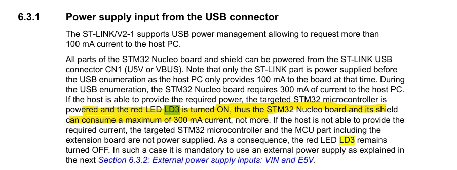

According to the User Manual, LD3 shows an overcurrent event (which in your case is red)
