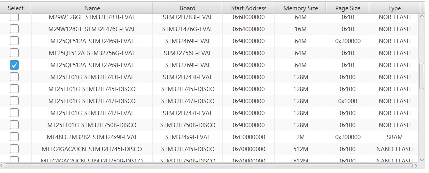

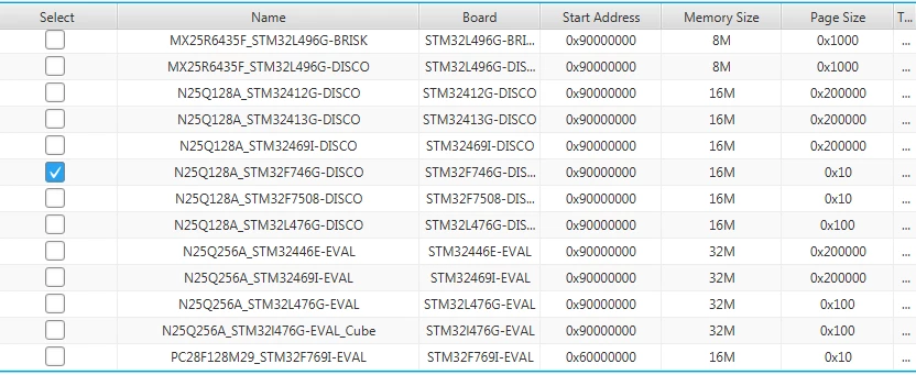

While doing some research I found that cutsom board external flash is a common problem for many designers. Mostly they were saying the same thing as you to write our own external loader. This is not straightforward so I will need to look into that deeper, I wish if was just a simple text configuration file. They also advised to use STM32Cube Programmer rather than ST-Link. After doing so I found a way to fool the STM32Cube Programmer without spending time on writing an external loader.
1- I select on the external loader the N25Q128A with the STM32F746 Disco
2- I go to memory & file edition tab and type address 0x90000000 then do a read. This gives me access to the external flash.
3- I go back to the external loader and select MT25QL512A flash
4- I go to Erasing and Programming tab and program the chip.
I think the first step allows to set the microcontroller QSPI and the 3rd step allows to have the right chip ID checked.
