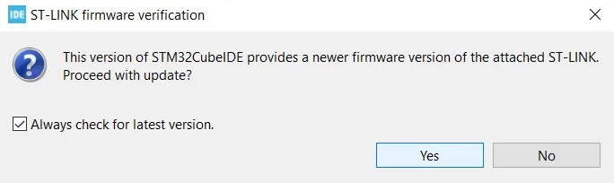

I have the ST-LINK programmer. I want to run a code from ST32CudeIDE. When I started to do then, I got a message:
0693W00000Y93hSQAR.pngOk, so I pressed the Yes button, and I got an answer:

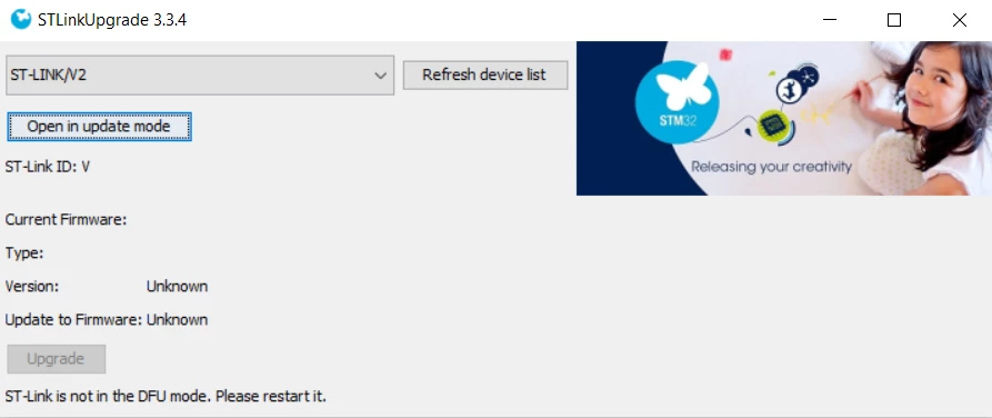

0693W00000Y93fbQAB.jpgI clicked the Open in update mode button, but...

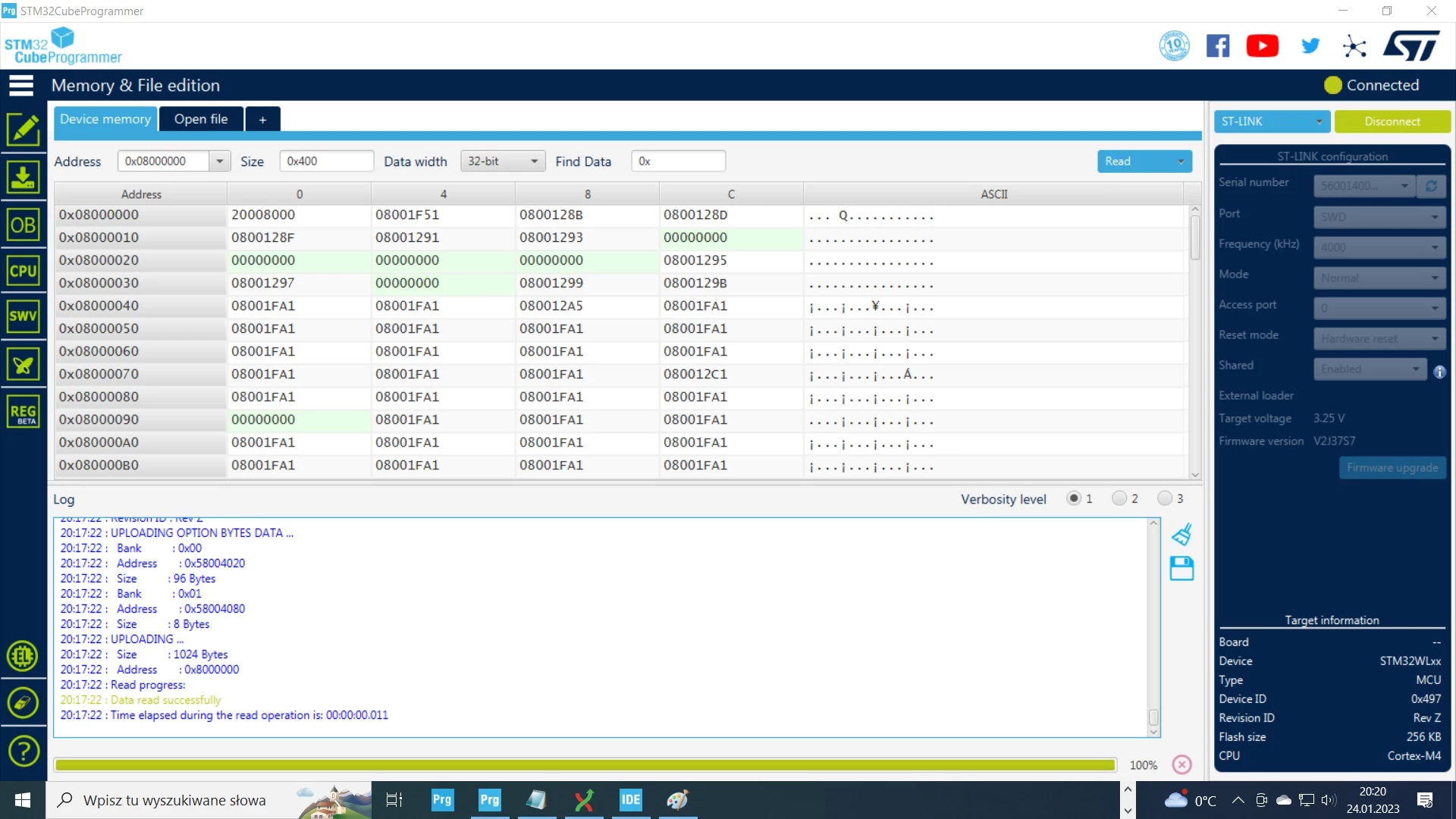

0693W00000Y93liQAB.pngI have ST-LINK connected.

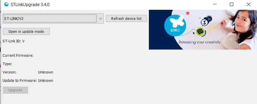

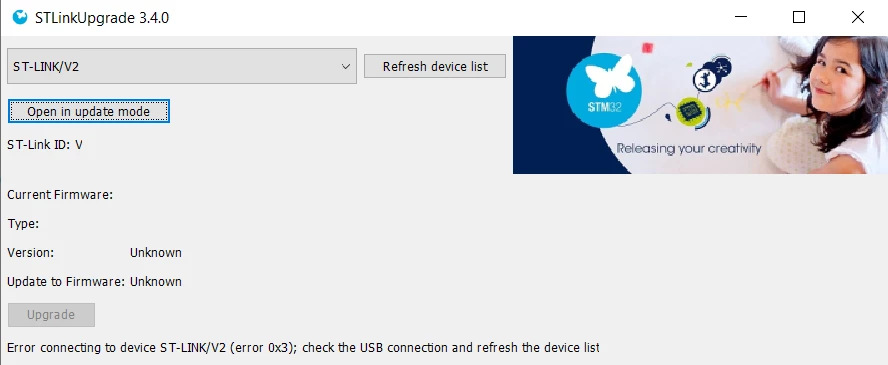

0693W00000Y93kuQAB.jpgOk, I saw an option "Firmware upgrade" option inside ST-LINK. So I tried to use this option. I disconnected ST-LIINK and clicked on this link. And I got:
0693W00000Y93n0QAB.pngWhen I made a connection, then this link was dimmed. So I have a question: Is it possible to upgrade ST-LINK firmware? Such a situation looks like a joke.

This is not a joke, but a problem, which has been discussed here many times and usually occurs with ST-Link/V2 counterfeits that are not only not made by STMicroelectonics, but contain a poorly made fake instead of the original STM32F103. Especially the V in the ST-Link ID in your last picture already draws attention to the fact that it is a fake. Have a look at this thread and then decide how to proceed - e.g. return the ST-Link to your dealer.
