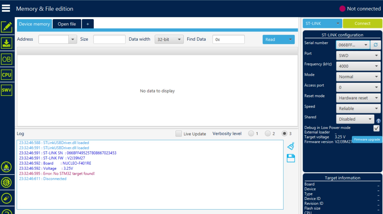

ST-LINK error: “The interface firmware FAILED to reset/halt the target MCU"
I have a new Nucleo F401RE board that I have been programming with a Mac and uploading code via the mass storage normally, until yesterday. Now when I connect it using USB to either Mac (12.3) / Windows (11), the device folder has a FAIL.txt file that says “The interface firmware FAILED to reset/halt the target MCU�?. On the board, JP1 is disconnected, JP5 is on U5V side, JP6 is on, and both CN2s are on. I have also upgraded the ST-LINK firmware to the latest, but the problem still persists and it doesn’t allow me to upload code (with an error saying “No space left on device�? despite that my code only takes up less than a tenth of the storage). Furthermore, my Mac also shows that the board volume has in total only 33 kb, instead of the correct 512 kb.
Any help is greatly appreciated!!

Can you connect and upload code with STM32CubeProgrammer?

Thanks for the reply! I just tried, but STM32CubeProgrammer doesn't seem to be able to connect to the board either using the ST-LINK interface. The error is "No STM32 target found".0693W00000LyAlaQAF.png

Did you reassign the SWD pins?
Try connecting with Mode: Under reset.
Not real sure. Boards are not prone to failing randomly. You don't recall doing anything or any events happening which caused the behavior?
