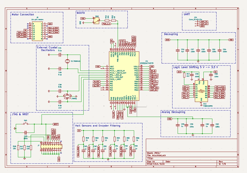

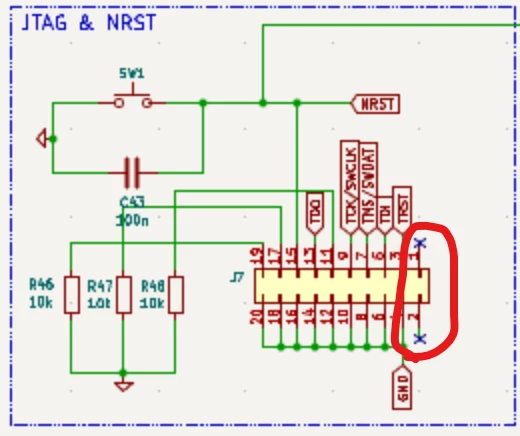

I checked all the connections and VDD pins with decoupling caps and looks like everything is properly connected. Yet still I don't understand what is the reason of not connecting. Schematic of the project:

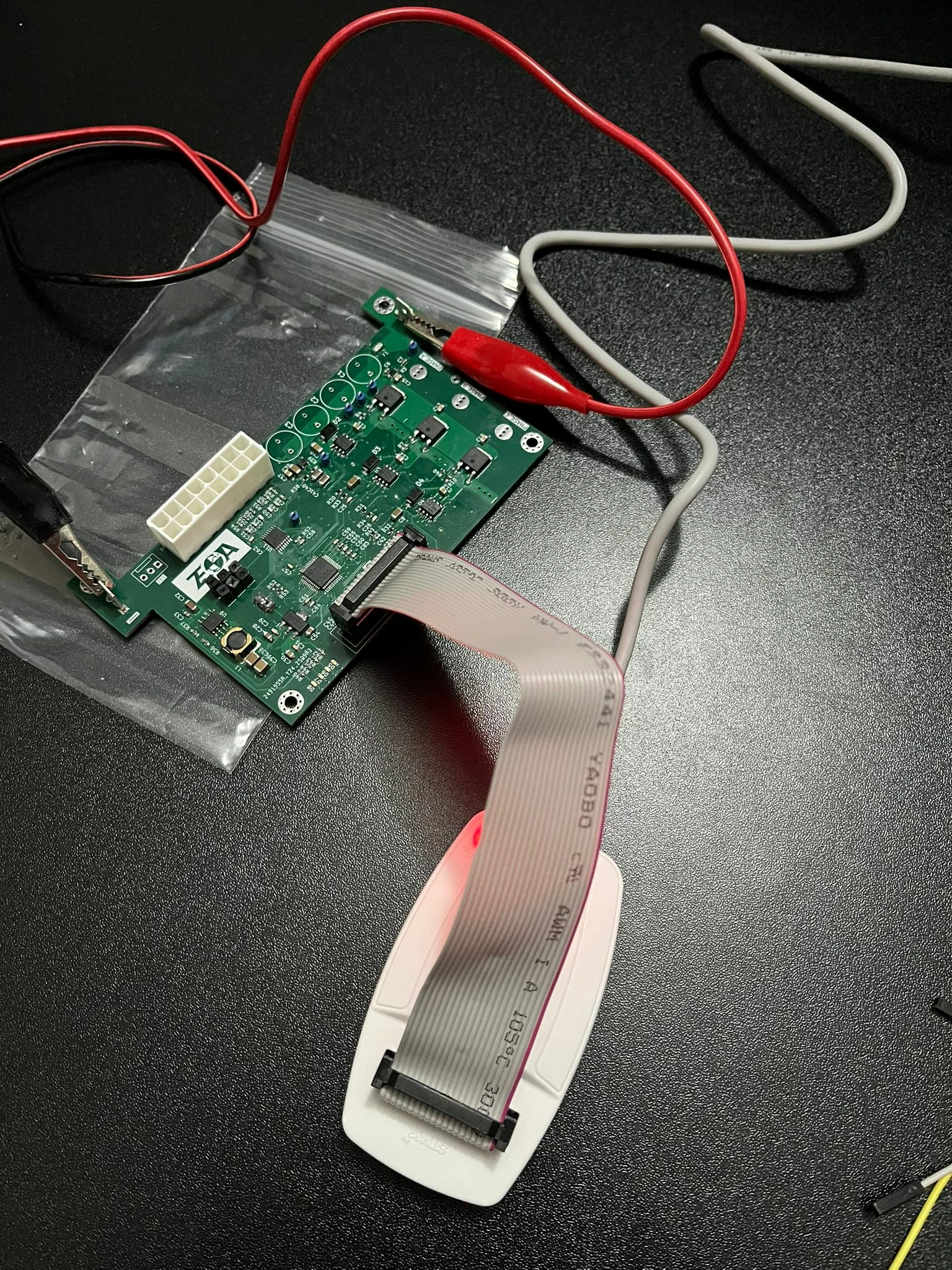

Physical connections:

Most of the design is just copied from the Reference design STM32G4 Series document.

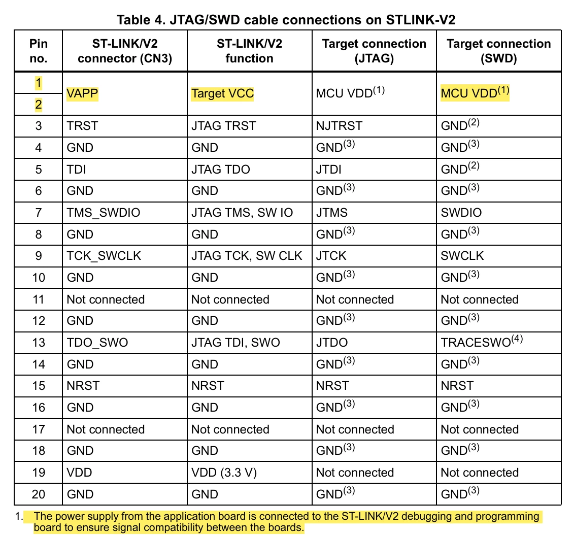

Pins 1 or 2 need to be connected to VDD in order for the level shifters to work. It is not optional.
Voltage needs to be reported correctly in STM32CubeProgrammer.

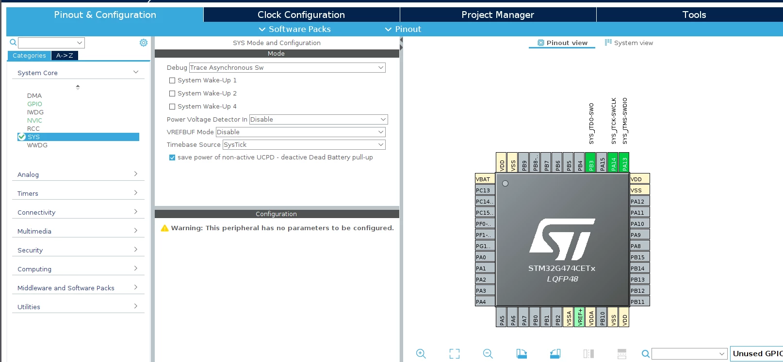

Okay providing +3V3 to pins 1 and 2 solved the problem. But just temporarily. I can flash the program but I am unable to see register content , Live Variables, Variables, literally everything is greyed out. This is my .ioc:
Dec 21, 2025 3:51 PM UTC
If you have a new problem, mark a solution here and ask it in a new thread. Provide a relevant screenshot. Nothing is grayed out in the screenshot you provided.
