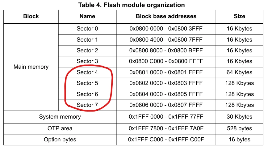

Graduate
May 9, 2024
  • The same error, when using ST STD PERIPH library specifically to erase flash sector 4 on NUCLEO-F446RE dev.
  • One more observation is the issue doesn't happen when all the sectors in the range 4-7 are erased.

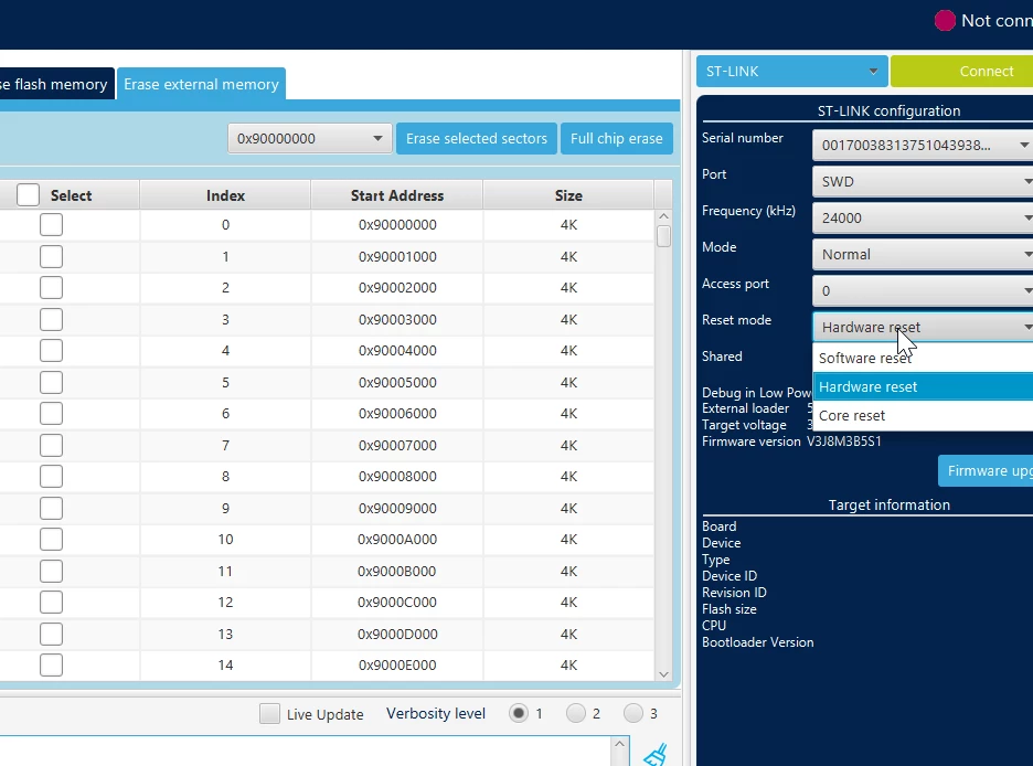

Hueli.1
August 12, 2022
0693W00000QNa8kQAD.pngI had the same issue after flashing a corrupted build.
The solution is to select Hardware reset under Reset mode in STM32Cube Programmer
