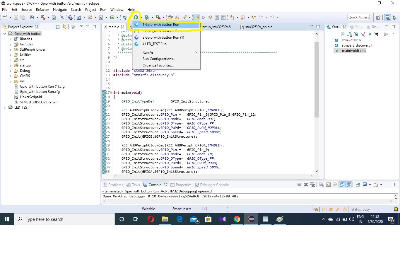

Hello Team,
I am using System Workbench for coding of STM32f30xx series micro-controller.I m getting some error on regarding St-link match frequency , that is below:-
Open On-Chip Debugger 0.10.0+dev-00021-g524e8c8 (2019-04-12-08:48)
Licensed under GNU GPL v2
For bug reports, read
http://openocd.org/doc/doxygen/bugs.html
srst_only separate srst_nogate srst_open_drain connect_assert_srst
Info : The selected transport took over low-level target control. The results might differ compared to plain JTAG/SWD
adapter speed: 8000 kHz
adapter_nsrst_delay: 100
Info : clock speed 8000 kHz
Info : STLINK v2.1 JTAG v29 API v2 M18 VID 0x0483 PID 0x374B
Info : using stlink api v2
Info : Target voltage: 2.915101
Info : Unable to match requested speed 8000 kHz, using 4000 kHz
Info : Stlink adapter speed set to 4000 kHz
Info : STM32F303VCTx.cpu: hardware has 6 breakpoints, 4 watchpoints
Info : Listening on port 3333 for gdb connections
target halted due to debug-request, current mode: Thread
xPSR: 0x01000000 pc: 0x080005c4 msp: 0x2000a000
adapter speed: 4000 kHz
** Programming Started **
auto erase enabled
Error: Invalid command argument
image.base_address option value ('button.elf///') is not valid
embedded:startup.tcl:476: Error: ** Programming Failed **
in procedure 'program'
in procedure 'program_error' called at file "embedded:startup.tcl", line 535
at file "embedded:startup.tcl", line 476
Due to this micro-controller can't burned with my code, how to set this frequency?

You do not actually show, what comman is given to the controller. So showing your user program does not help. You must dig deeper. Or perhaps try some example from a tutorial first, if you find such a tutorial. If something in a chain does not work, you have to break up the chain into smaller units.

The error is not related to the interface speed. You do not show the command line used. I guess, you try to upload some invalid file, e.g. some C-file.

Thank you to reply actually i am using System workbench IDE so when I give command to flash the micro controller then it is showing such error.
I will share you screen shot of it.
Below is my code:-

In attachment highlighted area is by which I will flash my program into MCU.
