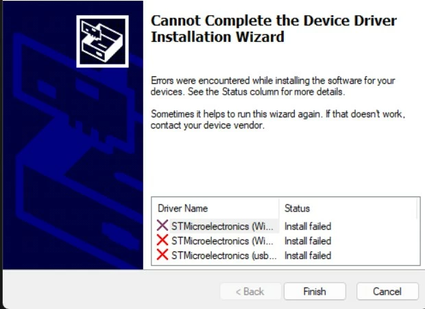

I have been trying various methods of installing the ST-Link USB drivers on my Windows 11 Laptop, with absolutely no success. Here is the output I see when I try to run the installation batch file from the stsw-link009 download:

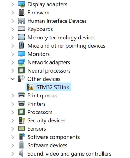

0693W00000KagBhQAJ.jpgWhen I plug in my nucleo board, this is what I see in the device manager:
0693W00000KagCBQAZ.pngWhen I open the properties on the ST-Link device, it (obviously) says that the drivers are not installed. Needless to say, if I try to run a program form the Cube IDE, I get a "No-ST-Link Detected" message. Also, if I open a project on the mbed IDE while the nucleo is plugged in, the board does get recognized. The board is the F091RC, although I am not sure that's relevant to my issues. The pre-loaded blinky program does work as well.
I am a beginner in this space, so please let me know if I'm doing something dumb. I've read and watched a lot of things to try and figure out, and everything I've found either completely skips over any issues with this (so presumably it isn't a normal issue) or they dive into writing custom INF, disabling Secure Boot, or other relatively extreme measures.

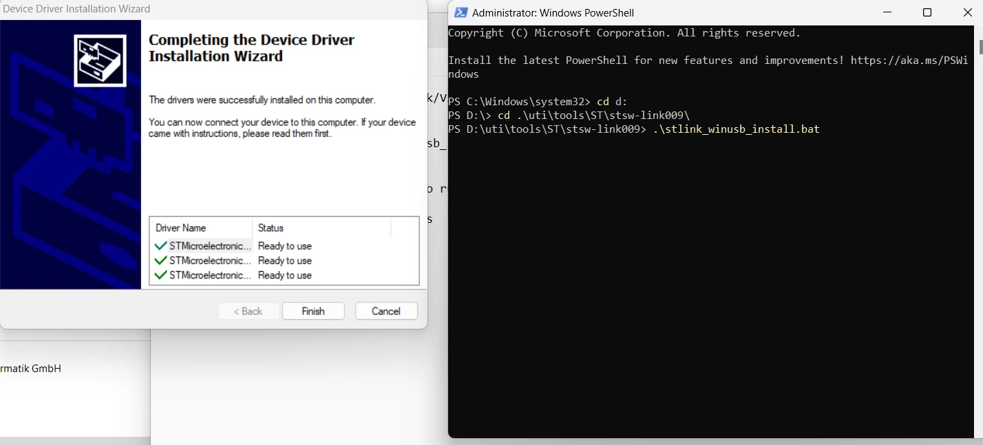

Pavel A.
Dec 16, 2023 6:03 PM UTC
@BillE Confirmed. Works on recent supported Win11 on Intel/AMD PC (ver. 23H2, 22H2)

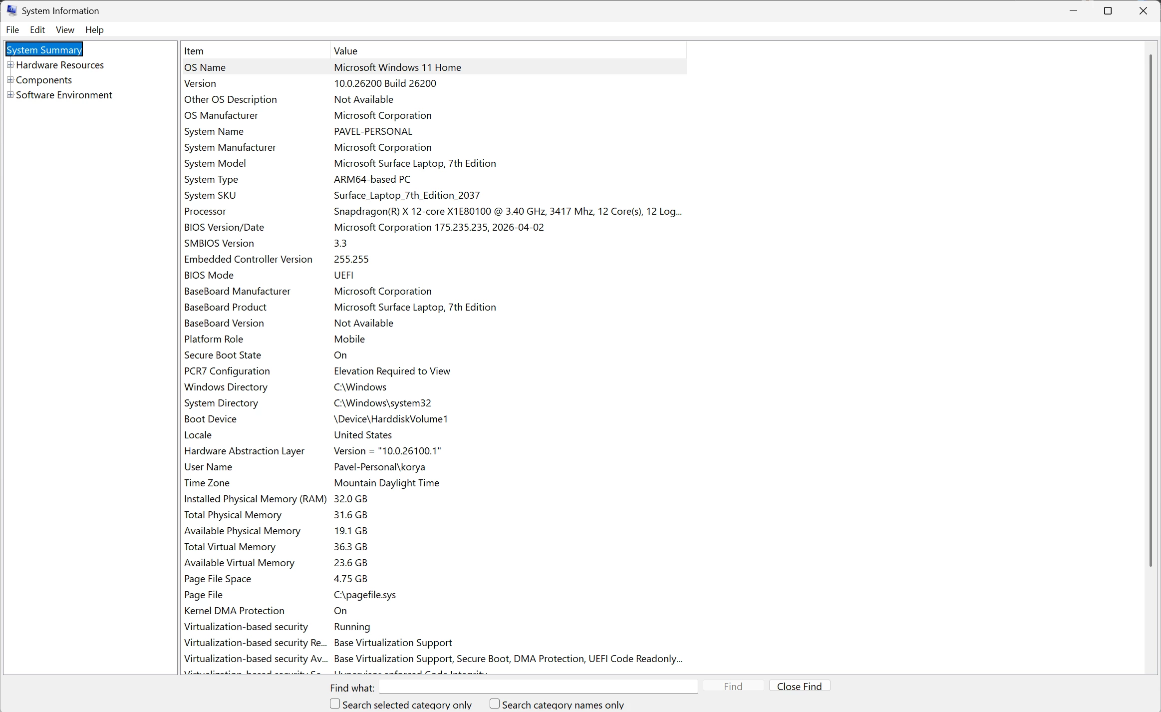

What is your Win11 machine- a Qualcomm laptop? What do you see in Device Manager?
