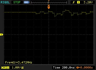

dimchik_b
dimchik_bAuthor
Aug 21, 2017 3:54 PM UTC
Posted on August 21, 2017 at 17:54
I've checked signals with an oscilloscope. It seems a port responsible for NRST signal is burned out. Sometimes access to an MCU is successful, sometimes not, but a shape of the NRST is far from normal.
By the way, how to say in English that a chip is broken but not fully like in this case?
