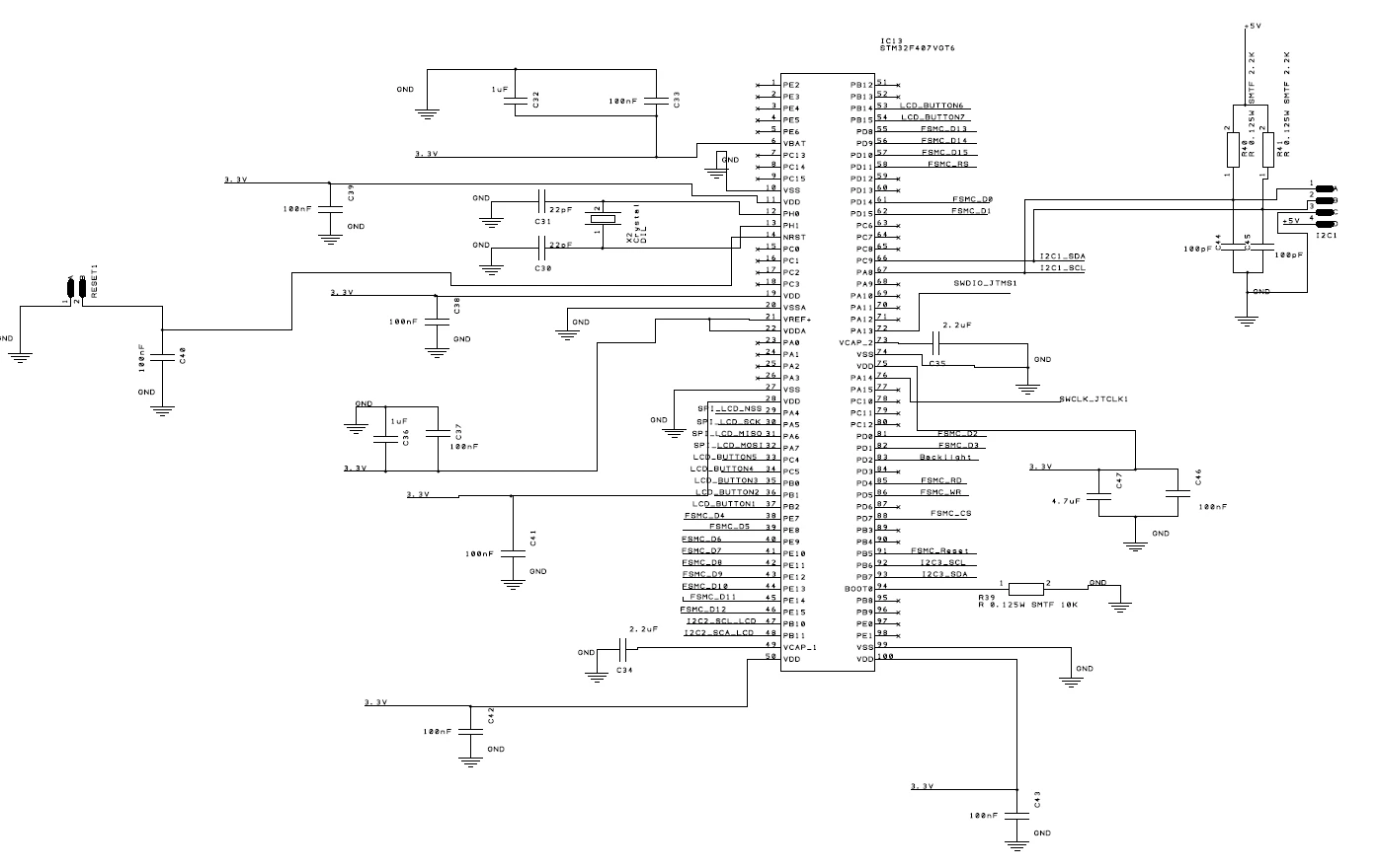

Hi everybody,
I have a problem with my project. I designed and produced a PCB with two MCUs, the STMF401RB and the STM32F407VGT. I am using the ST-LINK V2 to program them and SWDIO and SWCLK. The problem that I have is that I can connect to the STMF401 but I can't connect to the STMF4 I checked the VDD and VSS in every pin and they seem to be ok. I think the design is ok but may be i missed something. I have attached the schematic that I used for the STMF4 I would be grateful if you can help me.
Thank you very much
Regards
Gregorio

Nor Sch
January 24, 2017
Posted on January 24, 2017 at 12:09
To make things easier, could you please add the Pins for the ST-Link-Header? So it's hard without Datasheet or Cube to find them. Just a little Hint: maybe you have a Problem with the Reset-Pin (NRST)? Often something with this Pin and the Configuration in your cfg-File is wrong. Search for 'reset_config none', maybe this helps.

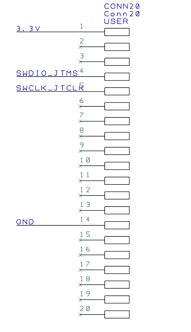

Gregorio Vidal
January 24, 2017
Posted on January 24, 2017 at 12:38
Hi sch.nor,
Thank you for your reply. I have attached a image of the ST-Link header in the PCB. I am using the SWDIO and SCLK signal which are connected to the pins PA13 (SWDIO) and PA14 (SWCLK) of the STM32F407. I am using the same header and the same configuration for both MCUs and I am using a switch to swap between them.  The STM32F401, which I can connect to, has pin SWDIO in high level and the SWCLK pin in low level before connecting  to the ST-LINK. However the STM32F407 has both pins in high level.
I used the osciloscope to see both signal(SWDIO and SWCLK) when the MCU is connected to the ST-LINK. For the STM32F401 they both change between high and low level, which is normal, but for the STM32F407 there is not change in the signals
In my configuration the reset pin is floating. Anyway i will have a look at this as you told me.
Thank you for your help

Mon2
Senior III
January 24, 2017
Posted on January 24, 2017 at 14:40
R40 & R41 are I2C pull-ups connected to 5v0 rail for this 3v3 powered CPU. Confirm this is acceptable for the I2C port pins. Test by removing R40 & R41 for now or connect to +3v3 till you have your ST-Link working with this custom PCB.
On I2C, the caps C44 & C45 are not required and can impact your performance of this interface.
Gregorio Vidal
January 24, 2017
Posted on January 24, 2017 at 15:13
Hi bhatia.kumar,
The I2C ports are 5V compatible and i think the most of the ports in the STM32F07 are 5V compatible. Anyway to test this part of my costume board I am using just the 3.3V, not the 5V.
About the I2C configuration with the capacitors, I tried it in the other MCU in the board and It seems to work ok, but If I have problems I will remove the capacitors.
Thank you
