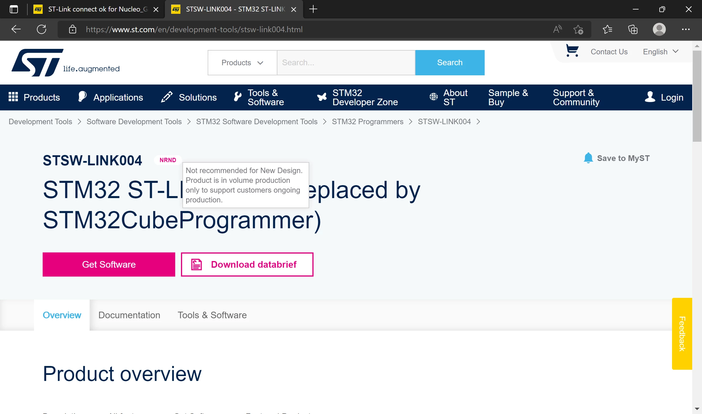

ST-Link connect ok for Nucleo_G474RE, but NOT for Nucleo_G491RE
I really have much exprience with many STM32 products (STM32H7, STM32F4, STM32L, STM32G0, STM32G4).
Typically for first board check of new PCB I use ST-Link.
I have a weird problem, that my ST-LINK refuses to connect to STM32G491 devices (neither on my own PCBs, nor for Nucleo-G491).
If I resolder the controller to STM32G473, then connect works fine. Also Nucleo-G474 connect works fine in ST-Link.
Is there anything special to do to connect to STM32G491? (Nucleo-G491 ... I have two such boards, both refuse to connect, but LED blinking all fine... same as G474).

ST-LINK UTILITY does not support G491.
Please try to use STM32CubeProgrammer.

I just downloaded newest ST-LINK from STM32 Nucleo-G491 page:
Menu ST-LINK - Help - About - Info:
STM32 ST-LINK Utility v4.6.0.0
STLINKUSBDriver.dll v5.1.2.0
ST-LINK_CLI.exe v3.6.0.0
The Firmware of the Nucleo_G491RE is shown (Menu ST-LINK - ST-LINK - Firmware Update - Device Connect ... here strangely Device connect works, but only in this "Firmware update window" (also if I plug the Nucleo_G491RE to my Win10 PC by USB, the USB window pops up...)):
The "Firmware update" shows after "Firmware Device Connect" for "Current Firmware": V3.J10.M3
The "Firmware update" for my Nucleo_G474RE (which works nicely for "normal" Device connect) shows for "Current Firmware": V3.J2.M1

One strange difference in the "Firmware update window":
The working Nucleo_G474RE shows in the MCO output line: "Default (HSI/2 8MHz)" marked.
The non-working Nucleo_G491RE shows in the MCO output line: "Other" marked. (this checkbox "Other" appears only for Nucleo_G491RE ... the Nucleo_G474RE does not even show such checkbox "Other").
My second non-working Nucleo_G491RE shows "Current Firmware" V3.J6.M2, and also "Default (HSI/2 8MHz" marked (also does NOT show "Other").
Both Nucleo_G491RE do not connect by toobar button / Target menu (but they strangely connect in the "Current Firmeware" menu).

Ups, this is surprise to me.
So there is a real severe difference between STM32G474 SW-Debug-Interface and STM32G491 SW-Debug-Interface? (I always use the two wire debug lines SWDIO and SWDCLK together with NRST-Line, so together with GND it is a small 4 pin connector).
Is it possible to use Keil uVision Debugger with STM32G491 (SWDIO/SWDCLK), or should I expect here similar problems as with ST-LINK? (As Interface to Keil uVision, I use such a Nucleo ST-LINK interface...).

What a surprise, you are right ... CubeProgrammer works nicely, and also Keil uVision.
Thanks a lot, this made my day... .
(But it's a BIT nerving, that there seems to be no comment about this "strange behaviour" in the documentation, neither in STM32G491 datasheet, nor in STM32G4 reference manual / at least I did not see anything...).
