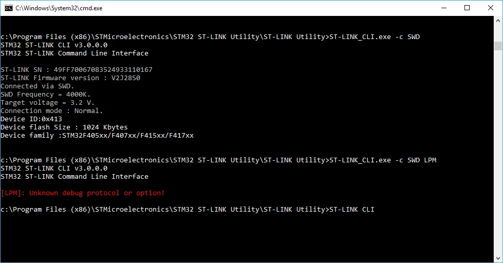

Just I want read a some memory area from my F4-DISCO for monitoring values.
So, first I start
ST-LINK CLI with following arguments:
ST-LINK_CLI.exe -c SWD HOTPLUG -r8 0x20018000 0x100
and this works (i.e. read data) fine, but processor gets the stop-state during data read and runs again after.
Second, I trying to run CLI with additional LPM option, like this:
ST-LINK_CLI.exe -c SWD HOTPLUG LPM -r8 0x20018000 0x100
But the ST-LINK CLI returns a error:
[LPM]: Unknown debug protocol or option!
I tried a different options and it different order in command line, but not success.
Who can explain what's going on with CLI and how I can resolve this issue?

Did you ever get a solution to this? The manual still says '-c LPM' is a valid option. I'm trying it today and getting the same error you got.

STM32 ST-LINK CLI v3.0.0.0

This issue will be fixed with the next version of STM32 ST-LINK Utility (V4.3.0).
