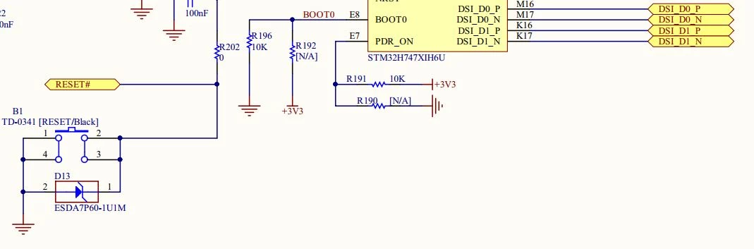

==> Pull boot0 pin high.

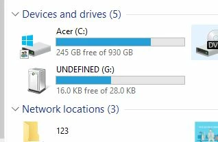

Weird thing when i connect the device to the PC via USB the device is shown 28KB out of which 8KB free. That free KB size varies too.
Also i checked the voltages in the pin header and i am getting 5V between 5v and GND pin but not getting any voltage between 3v3 and GND pin.
