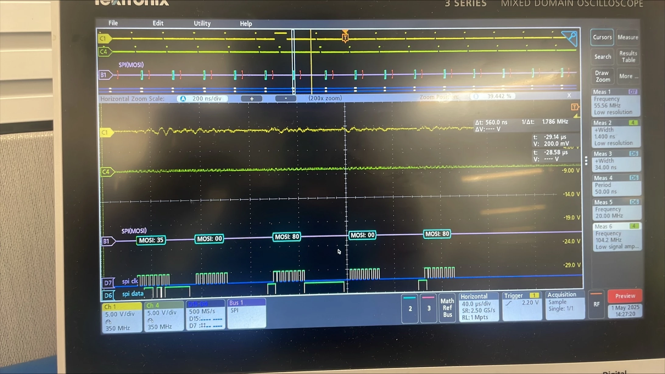

Hi, I've been trying to receive 5 bytes of data from a master MCU using SPI in slave mode.
I have a timeslot control signal, and on each falling edge of that signal, I need to receive 5 bytes from the master.
The timeslot control signal consists of one long pulse followed by 15 short pulses.
Exemple: i receive the data for timeslot 0 at the end of timeslot 15 and so on.
I want to start receiving data from the second cycle of the timeslot control signal, and stop at the end of that cycle,
so I can compare the received data with what I’m supposed to get.
the yellow signal is my timeslot control and the green is the duration of the HAL_TIM_PWM_PulseFinishedCallback
here is my code:

I put tim7 for the dma timeout (3 microseconds).
My problem is that:
when i put a breakpoint on read_data_finished = 1; and i have a free run PWM

how can i have is_timeslots_readed[15]=0 (that mean dma not finished) and
rx_all_data[15]uint8_t [5]0x2000008f (Hex)
rx_all_data[15][0] uint8_t 0xe0 (Hex)
rx_all_data[15][1] uint8_t 0x60 (Hex)
rx_all_data[15][2] uint8_t 0x35 (Hex)
rx_all_data[15][3] uint8_t 0x60 (Hex)
rx_all_data[15][4] uint8_t 0x0 (Hex)
It’s supposed to be 0x00 everywhere, isn’t it?
If i reset and  i jumb again on that breakpoint i will probably have something different and when i put uint16_t NumberOfTS_Cycles_to_Run = 2, i have the same problem?
Is there something that did not do correctly?

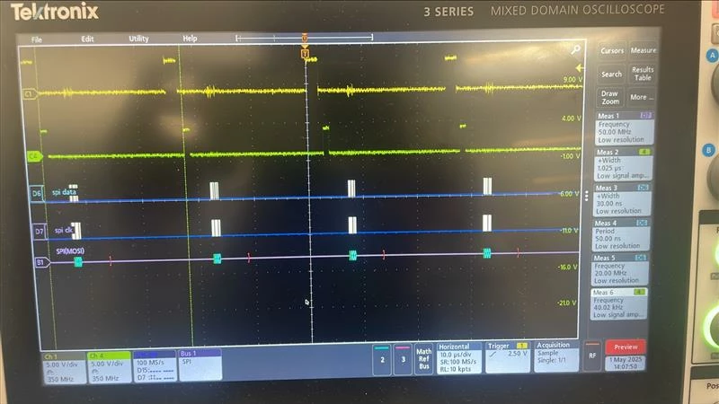

Hello @okeycii and welcome to the community;
Which STM32L4 are you using?
Do you get the same issue when you start receiving data from the first cycle of the timeslot control signal?
Thank you.

KDJEM.1
May 14, 2025 2:29 PM UTC
Hello @okeycii;
Which STM32L4 devices are you using? Is STM32L496?
What is the QSPI and SPI frequencies?
Try to increase the timeout.
Thank you.
